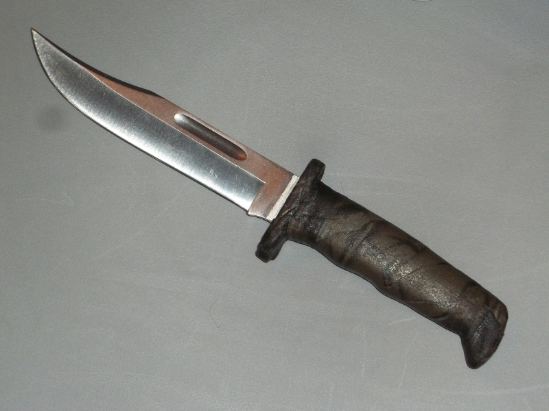

What should I do to improve the grip (traction) on the black phenolic handles? Automotive wet sandpaper maybe? If yes, which grit? Thanks.
That will work. What ever you have on hand. Try fine, 220. If that doesn't work, you'll know which way to go. DM
Bicycle handlebar tape? How about the camo tape you wrap around your shotgun barrel? You could renew the tape easily and you knife would still be unaltered. Beadblasting? Buck beadblasted some of the phenolic handled 639's. Haebbie has shown pictures of his on here in the past. I had a jar of liquid plastic once, it was used for dipping tool handles in as I recall. Can't remember why I had it or what I used it for.
I started to sand one once and backed off... it felt like I was ruining it.
I would like to try the material Talon grips uses for firearms. It works well for that. No glue, hair dryer seals it together.
I make custom knives and depending on what phenolic it is you can use sand paper. I do recommend a respirator as most of those whether it is g10,micarta or some other put off some pretty nasty dust.
220 grit seems to have an ok feel to me, sometimes I will take a chainsaw file and make some serrations in the handle but that all depends on what the knife is and the look you want to achieve.
Here is an example of what I ment by the chainsaw file and serrations or grooves.
