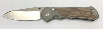

I received a brand new Small Inkosi Insingo w/ Natural Micarta from my AD today. I know this has been beaten to death, but this is the first CRK that I have owned that has a ceramic ball for the lockup. I know by looking at the blade open it is an illusion that it is ~85%, so when looking at the mark on the tang from the ceramic ball it looks ~50%. Am I correct in my assumption? It is a solid lockup and no blade play. It should be okay, correct? BTW - this Inkosi is the sharpest knife ever to come direct from CRK.

Yes, that is normal for CRK with the ceramic ball lock. I have the Sebenza 25 (basically the same as large Inkosi) and it almost looks as though the lockbar is all the way towards the other scale when the blade is open. Same as you said with the mark on the blade tang is only about 50%. Just the nature of a round ball being used to contact a flat surface.
To ease your potential worries, I've used mine for nearly a year and the lockup hasn't migrated at all. ;)
Yup its correct as stated above. The ceramic ball surface that actually touches the blade tang is a bit away from the edge of the lockbar surface.
Inkosi/25/Umnumzaan lockup % basically what ever it looks like when open deduct ~30% or so.
+50% was preferred with the 25 at least, from what I read a while back from CRK & was w/in spec. Could be mistaken though.
hodo615 hodo615 It's perfect. I find I like the deeper set on the Inosi and ‘Zaan. IMO, it feels more secure set deep, especially when pushing the blade.
I simply don’t care if it’s at 99%, as long as it works well and properly. Besides, if you grip an Inlosi solidly for use, your gonna move that lock bar in some. I have yet to have a folder that won’t, but I don’t buy overbuilt folders. Tim stands behind his product and will fix it if it’s his or your fault. Use the tar out of it and send it in for repairs when it’s time. This is why we all buy these knives...or so I think.
