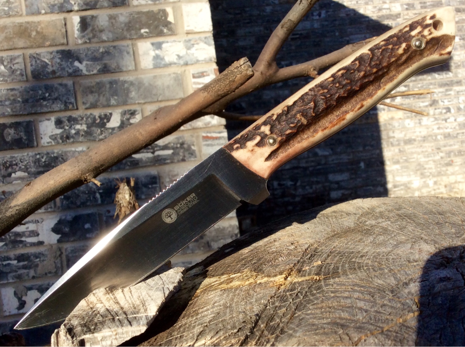

We still don't know what the op intends to use 440C for. IMHO, 1095 for a chopper. 440C for a cutter, if you only have a choice of the two. IMHO, 440C would be an upgrade from 9crmov or say, AUS8. Not very long ago, 440C was the go to stainless steel knife steel. There are still some knife maker's good lower mid-range production, and even some customs knives, made of 440C. Not my first choice for optimum edge retention, but it's still an awesome steel at its usual price point. Case in point:
The Boker Arbolito.
