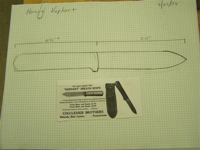

Jeez Pit. That sheath is a beauty. I'll be doing the one from the magazine article. That upswept is just not calling out to me at all. It seems corporate and provential. I will post pics today of the outline drawing I came up with. We can comment and I'll surely redraw it a couple of times. Then we'll make it up.

Here is a pic of yesterday's drawing.
5" blade, 4.75" handle, 1/8" thick 01 steel, blade 1.25" wide.
Right on Andy. That looks about perfect to me.:thumbup:
Add a choil, and im sold;)
Hey Andy, how about trying a version where you keep more belly toward the front and taper the top back down toward the handle ?
I have done a drawing to try and explain but you will notice that I'm no Picasso !!!!
How big is your knife there Pit? It looks to me like one of those medical Marine bolo's, but maybe I have the scale wrong. I'm planning to do a chopper, bolo style. That looks close to what I had in mind. It would be a big honkin som bit thoguh.

Andy, I'm sure whatever you come up with will be a winner. :thumbup:

"Double, double choil and trouble
Fire burn, and cauldron bubble."
Shakespeare agreed with you, Andy. :)
LOL ! Yeah I told ya I'm no artist !:o My scales is off, I was thinking of a 4 1/2-5" blade with a handle of 5" or so !!!
Here ya go Andy, MK2....I have tried to get the scale a little closer this time !
I just realised that my design is now starting to resemble my MOD4 ! Maybe that's what I'm looking for a shorter, thinner MOD4 without the guard ?
Yea. I like that knife too. Lookin more and more like a Nessmuk though...
Im likin the idea of the MOD with no guard. Looks very keppy like.
Pit, man thats a sweet knife. Id like to find me one of them.
