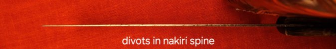

And since eye candy is in short supply among all this steel discussion, here are my two most used mid-size kitchen boys. Nakiri in unknown carbon steel somehow always feels sharper, after approximately equal sharpening, than the AEB-L Scrapyard WD5 below it at least partially because nakiri spine is almost exactly half as thick as WD5 spine (~1.4mm vs 2.8mm).
Apologize for the thread-veer, but can you tell us something more about the nakiri: blade length, who made it, where I might get one?

Blade is 6⅛" from point of heel to where nose radius straightens out vertically. Handle is 4.5" with 2" exposed tang on top, embedded by wood on the bottom.
It's a commercially manufactured knife. I have no idea who made it. I originally got it at a garage sale IIRC and gave it to my wife at the time, who used it a lot & seemed to like/appreciate it. When purchased it had some divots/chips in the edge and mushrooming along the spine. So this poor old warhorse had likely been hammered through frozen product, maybe chicken bones too is my guess. The blade/handle junction is straight. Parallax in picture makes it look crooked.
As for obtaining similar, I'd say use the dimensions, particularly thin spine thickness, to shop the usual vendors of authentic Japanese kitchen knives. Unfortunately, the market is so flooded with fakes & clones right now that dealing with the traditional players in the market, who have long-established relationships with in-country makers, carries more weight than ever.
Thanks for that clear and insightful response. The warhorse is lucky to finally be in good hands.
