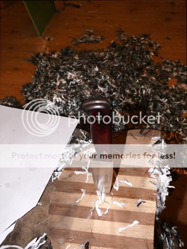

The test was conducted in 2 different days because the arm could not stand the physical effort.
The first day I did about 3000 while the other cuts I've made ​​on two days later. After a thousand cuts still have thrown in the towel and decided to stop the test because it seemed that the rope had no appreciable effect on the wire. In fact, after almost 4000 cuts, the Rasul has no difficulty in cutting the paper. The only uncertainty has it only to the curve that has rubbed several times on the chopping bamboo. The cutting board has also ruined a lot ...
cuts have been made to creep even if the thickness of the rope (20mm) is not allowed to make the cut easily.
at some point in the video I found a kind of plastic a little hard that I could not cut ... had to be a sort of junction of the inside ...
The fact is that I've had a bunch so much and the wire was still able to do its job.
Were enough to bring him razor 2 (and I say TWO) past a stick of ultrafine ceramic :cool:

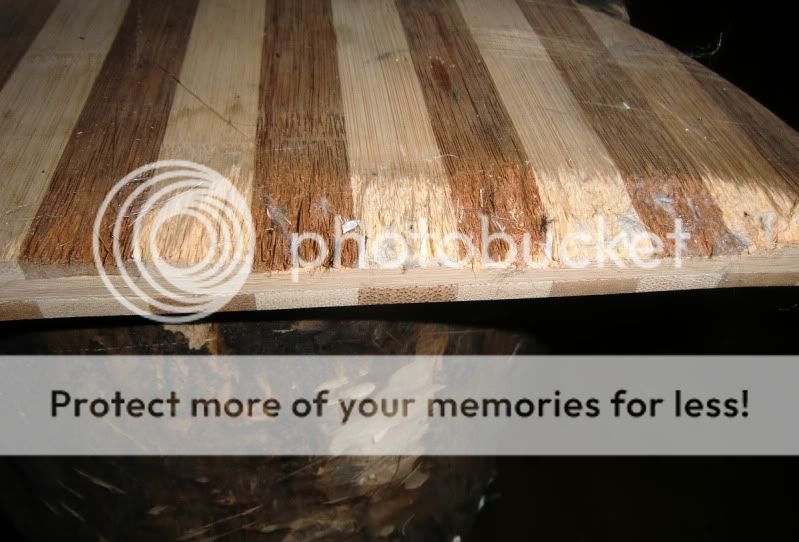

The cutting board is bamboo and the rope was leaning on it.
The thread that consumed the cutting board at the end of the test looks like this
