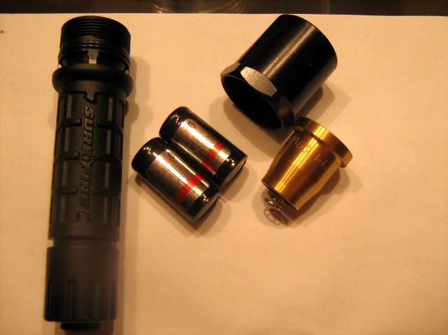

Standard operation is 2xCr123= 6 volts, Malkoff M60 operates between 3.8-9v, 2 AW Protected RCR123's at full charge are about 4.15 volts each for a total of 8.3 volts, getting closer to the max input voltage makes it a little brighter.
1) No, the protection means that it will prevent over charge and over discharge, this makes it safer.
2)They are the best rechargable R123. For standard primary use surefire brand or these are some good cheap ones http://www.all-battery.com/cr123alithiumprimarybatteries.aspx

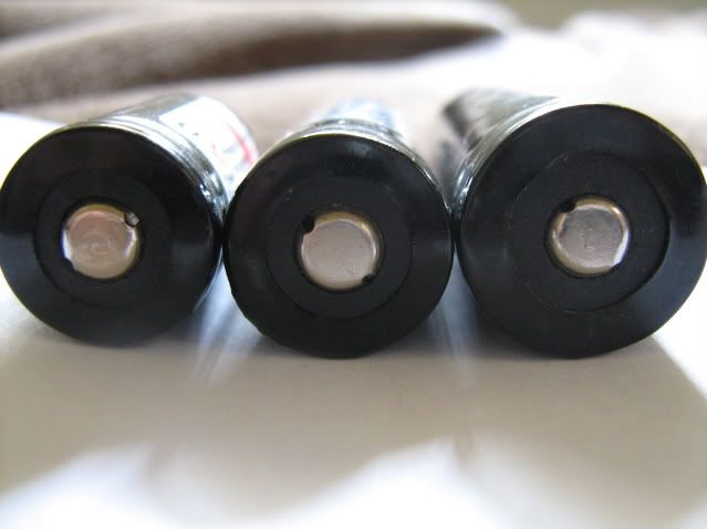

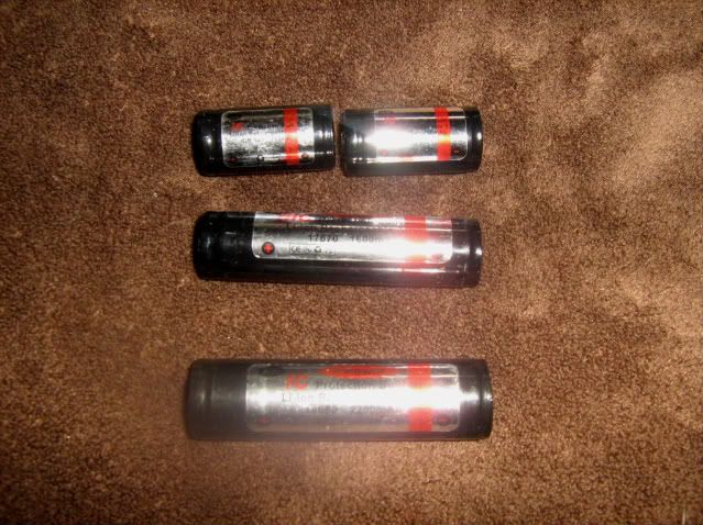

There is also a size difference that's what the first two numbers mean, 18650= 18mm dia. R123 (aka 16340) 16= 16mm dia. I think standard primary 123's are 14mm dia.
From left to right, AW's RCR123, 17670, 18650.
And a top view
The M60 will require the more voltage of the 123's because it drops out of regulation at 3.8v, so the R123's and some back-up primary's is the ideal setup for what you are getting, its how I have mine.
