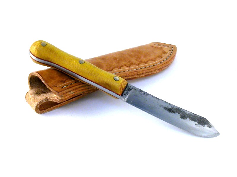

I sold my 6th. It was one of a batch of 6 Nessmuks. Sold 5 and gave one away.
The next batch of 6 were sold, and included my first Bushcrafter.

Cool pictures. The level of refinement from then to your current knives is inspiring!

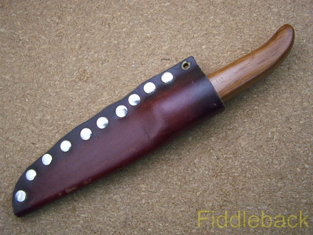

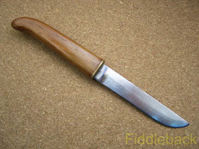

This is the first knife I ever made.

Looks a lot different than the knives you make today Andy. Is that a stick tang and epoxied in? John gave me a Helle blank and told me to handle it but I'm still trying to decide how I am going to do that. I have this image in my head of an antler "guard" and stacked wood instead of stacked leather but I'm trying to decide which woods.

Mist, two methods. 1. Use scales and a spacer the thickness of the tang. Thats the easiest! Flatten the scales, pick your spacer (wood is easiest) cut out shape of tang and glue to one scale, then glue on other scale. So easy.
2. make a mortice in material for the tang to fit in. Epoxy up.
