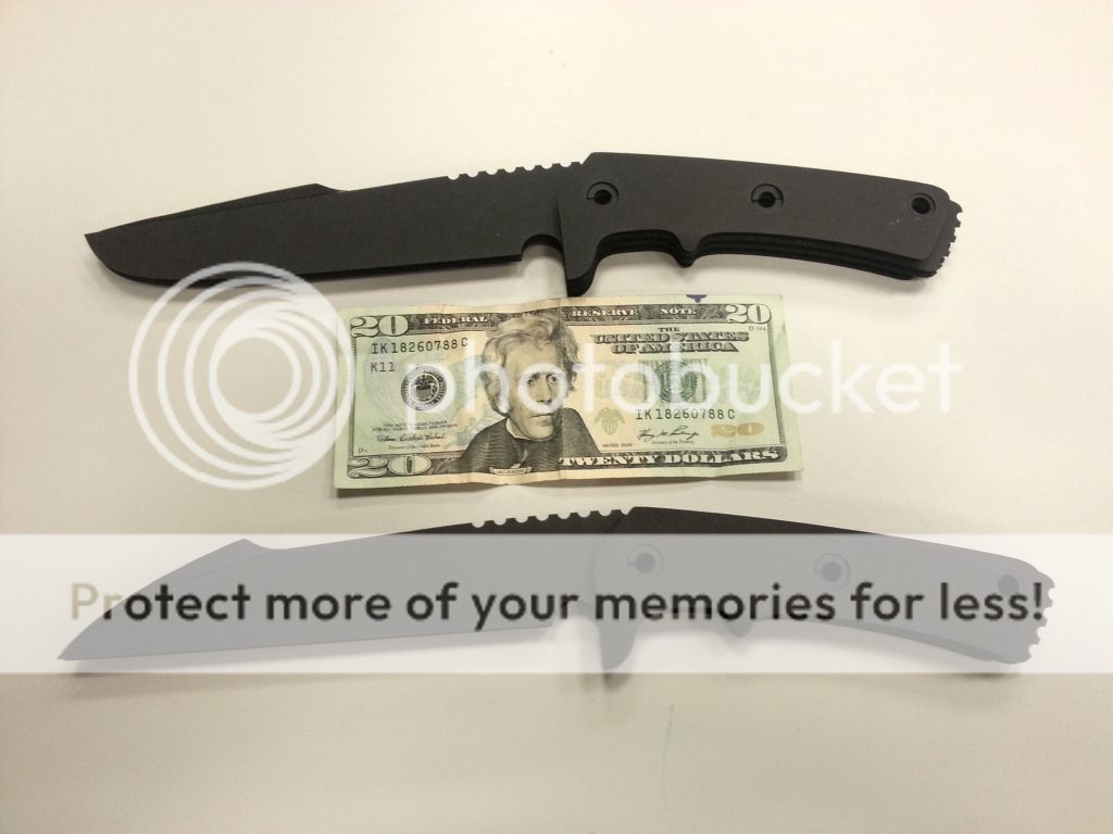

As you can see from the photos. I cut out a design, modify that, test it, make changes, cut a new design, and then compare the two. In 3 hrs I can test more than a dozen designs on a $2 sheet of foam core. Try that with steel or hand cutting cardboard. In my testing I found a 5 degree tilt to the handle to be superior for cutting tasks and swinging tasks. It just felt....right. Here I also settled on chain bolts to fasten the CNC handles.
The pictures are in chronological order from the first concept to last
Just throw one in with my TiTan, I will let you know how it is ;). But just my 0.02 I would buy #1 or #4. I like those shapes the most.
We sir, are in sync.
I finally chose two blade shapes that felt great in the hand and also fulfilled the original design criteria. These two designs will be offered as "Leviathan's".
The Harpoon Wharncliffe will feature a sharpened top edge more suitable for offensive/defensive cutting tasks.
The Harpoon Drop Point will feature a false top edge to aid in outdoor/survival knife duties.
Two knives. Two personalities. One soul.

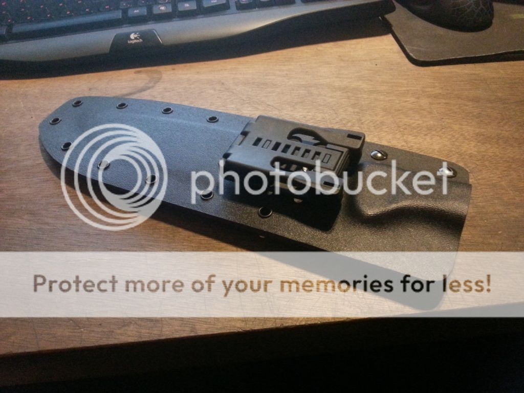

Example of my custom etched Leather/Kydex hybrid sheath with Tec-Loc attachment system.
It really the best of both worlds. Kydex's has strength and legendary blade retention. Using 9oz tooling leather is great for silent operation and allows for the feel of a friction fit traditional leather sheath.
Sorry for the crappy phone pics.
Awesome! That fighting sheeps foot is just full of badassery! But the drop point would probably be more usefull for general duties. Sucks growing up and having things like usefullness start to matter more than the CDI factor. Two great options that make it a tough choice to pick a winner. Great work! What are you looking at for scale options?

Personally I like the blade shape of the last one in this pic over the one you ended up choosing, but it's your choice. I'm just a sucker for spearpoints :D
Cheers
post number 11, knife second from the bottom, I like it! sweet mock ups on all accounts :)

I'm really digging the second knife from the bottom! Too bad it didn't make the cut. As for handles I think micarta or g10 would be nice. Have you put any thought into the blade finish?
nick, we both like that 2nd knife from the bottom... lets get some more on board and maybe leviathan 2.0 will be our pick :D
I like the wharncliffe and think it would look awesome with some nice carbon fiber. I want one of the Titans, but I love me a nice fixed blade.
carbon fiber, check.. and 2nd from bottom or possibly the bottom model; they both look to have the same blade shape but the bottom pic is a knife with a cant on the handle making it a bit more ergo for slicing.
BTW what is the thickness on this badboy if you've thought about that yet... 3/16 would be ideal considering the height of what it appears to be.. thinking slicer.. OH DAMN what steel are you considering... M4???? S90V???? S30V at 58-60 can prove to be insanely tough as a chopper and with the right grind, slice all day long... 1/4" pivots minimum...

The steel will be .21" surface ground CPM-3V with an RC of 59 (A perfect middle ground thickness between a fast in the hand 3/16" fighter and a 1/4" survival/chopper)
