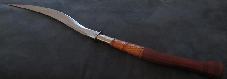

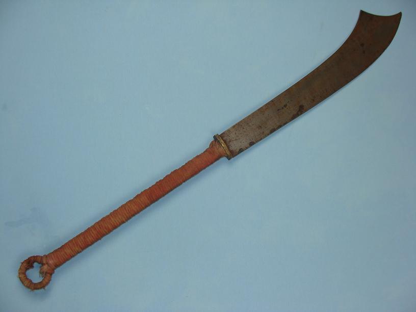

What are the pros and cons for these designs? I'm thinking they're relatively easy to craft, use less steel, probably handle better. But as a weapon, weight distribution must suffer, a shorter "sweet spot," no "forte". Lastly they just look funny.
Philippines "panabas" (hedge) trimmer
Burmese "Da"
Vietnamese "Da-dao"

I think that would be called a spear, more than anything. I doubt that a rapier blade would survive the amount of two-handed torque along a lever arm that long. It takes a lot less steel to make a blade on a stick, but it has to be made to take a serious hit. The dadao (usually chinese), kwan dao and pudao (horse cutter) are good examples of this; stout handles with thick-spined single edge blades on the end. On the other end of the scale, I have an early 20th century dha that is incredibly light and fast, but in order to cut anything of substance you have to hold it closer to the end for a longer lever arm. But that much force is also hard for that little blade to take, and it rolls so easily that I don't even try to do anything with it any more. It must be hard to get a workable "balance" between strength, weight and reach, but there are numerous examples across cultures that show how to get it right.

Some of them are primarily agricultural/utility blades (like lots of panabas, cane knives), often made to be used one-handed. More reach with less steel.
Ones made primarily as weapons are often intended for two-handed use. With these, you gain lots of leverage, which might matter a lot (e.g., parrying a bayonet thrust with a dadao). If the weapon is large enough, you also gain reach compared to the one-handed sword you might otherwise use.
For a one-handed long-handled sword, in some cases it might be better to think of it as a long-bladed axe rather than a long-handled sword. A battle axe - long handle, short blade - works as a weapon (less steel, lightweight, same disadvantages you listed), and a long-handled one-handed sword will be somewhat of a hybrid between a normal one-handed sword and a battle axe.
