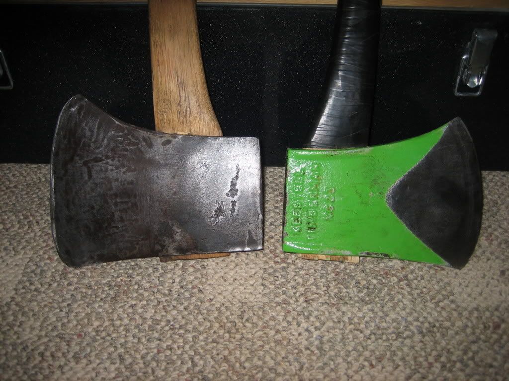

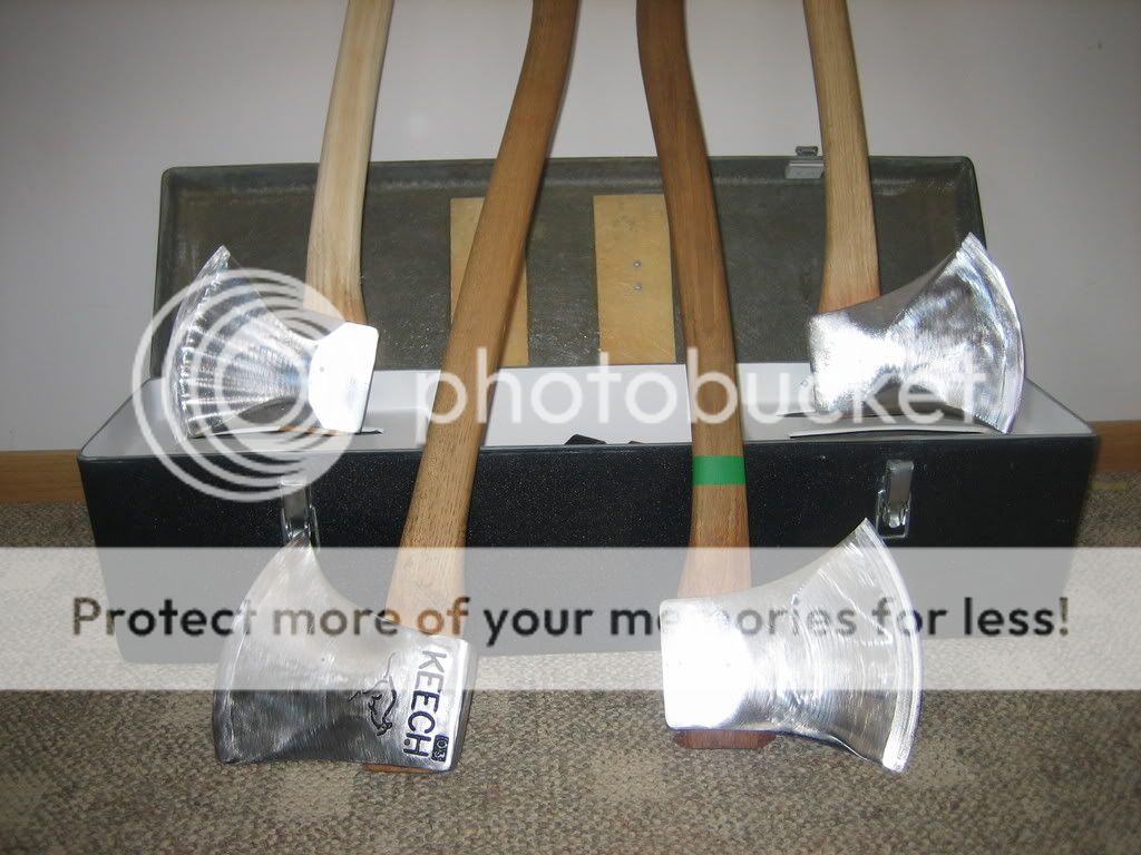

No problem. Here are my four racing axes and two practice/riggers.
Practice/riggers:
1. Main practice axe - the green Keech Timberman. This thing takes all manner of abuse, as I use it for pounding dogs, chopping footholds, peeling bark, etc. The last pic shows the wave in the blade I mentioned above, but it might be hard to see.
2. BIG practice axe. This is an Emerson and Stevens Handmade axe. It is over 8" long and weighs 6.5 lbs (head only). It is as heavy or heavier than ALL of my comp axes. I like to train with this one in the weeks before a comp, because it gets my wrists used to steering a big, heavy axe.
Comp axes:
Starting at the lower left, going clockwise:
1. Keech Racing axe (2003 vintage). 7 3/4 x 7 5/8 Chisel Grind. Done by Mike Eash. This axe was originally done up for a college team, so it is a little more rugged than some others. The shape is unlike any other axe I have ever handled, with that huge, swept-back heel. This shape makes it really nice for the underhand chop, as it helps keep it from getting hooked up on a bottom hit (one of my bad habits). This axe has started to lose its edge a bit, and is the one I always use in square wood, which is really tough on axes.
2. Brand new Tuatahi. 7 1/2 x 7 1/2 Supergrind set up for white pine. Done by the Tuatahi factory. More pics in the "new comp axe" thread. I have never swung this axe.
3. Tuatahi. 7 7/8 x 7 7/8 Mitre grind with a 5/8 chisel edge. Set up for popal. Done by Mike Eash. I ordered this axe as a copy of the axe below, which was owned by a friend of mine. This axe is an unbelievable cutting tool - the best axe in my box, but big and heavy. Hard to control.
4. Tuatahi. 7 7/8 x 7 7/8 Mitre grind. Done by Mike Eash. This axe cuts better than it has any right to, and is quite free in the wood. A glorious axe. A friend of mine owned this axe before me. It was such a nice one, I ordered a copy (as did a number of other competitors). Later, he suffered an injury and sold off most of his equipment. I was happy to be able to buy this axe from him. (It is worth mentioning that a used comp axe, if it has not been seriously shortened by regrinds, retains about 70% of its new cost, depending on several factors. Not such a bad investment). If a show has a round wood chop, this is the axe that is most likely to come out of the box. It is a bit lighter than the copy I ordered, and has a few minor imperfections which, though I don't think they do much to decrease its cutting ability, cause me to be less worried about getting a small ding. I save the above axe for clean underhand blocks.
Just how thin are we talking here, for the racing axes? Any chance of a top-down pic?
Here is a top-down pic of the Keech axe. I note as I look at it now, that it looks a bit thicker in the photo than it is. The apparent end of the bit on the photo is where the toe is. If you look at a profile pic, you'll note that the middle of the bit extends a ways beyond the toe and heel, so the average angle to that part of bit is more accute.

You have a splendid collection there! Thanks for taking the time to post the photographs. The one with the S curve in the blade almost hurts to look at, but the tool is still in good condition. What kind of money have you sunk into your axes? And, have you ever taken a blank and worked the edge up to contest grade quality by yourself?

Thanks. I hate to say they are my pride and joy....but, kinda. The green Keech, yes, hard to look at, but I really have to admit, that one hurt a lot less than the couple of times I have rocked my antique axes. They make more Timbermans every day. And it still does what I need it to. Plus, I now have no fear (and thus no excuse) about using it to practice in the winter.
I got a few of my axes second-hand or in trades, but to replace my comp box (box + four racing axes + one rigger) would cost just under $2000, and probably be a three month wait. Axes are CHEAP compared to race saws.
