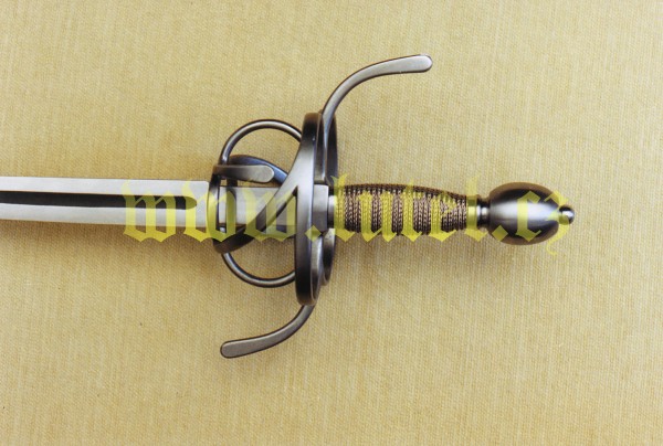

A pic would probably look something like this:
From their site www.lutel.cz
