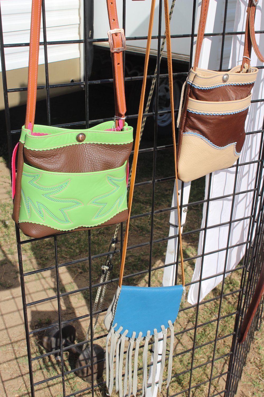

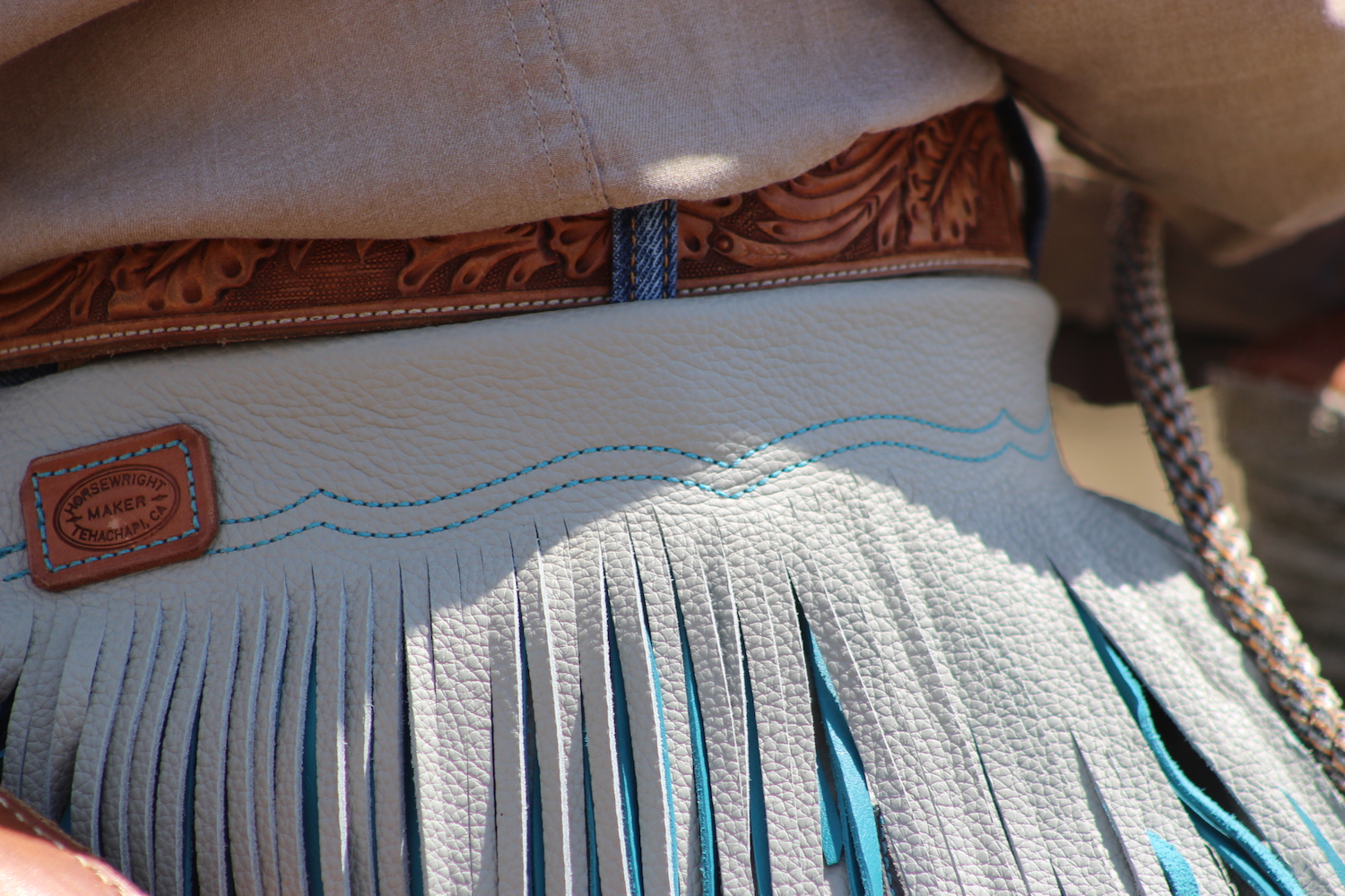

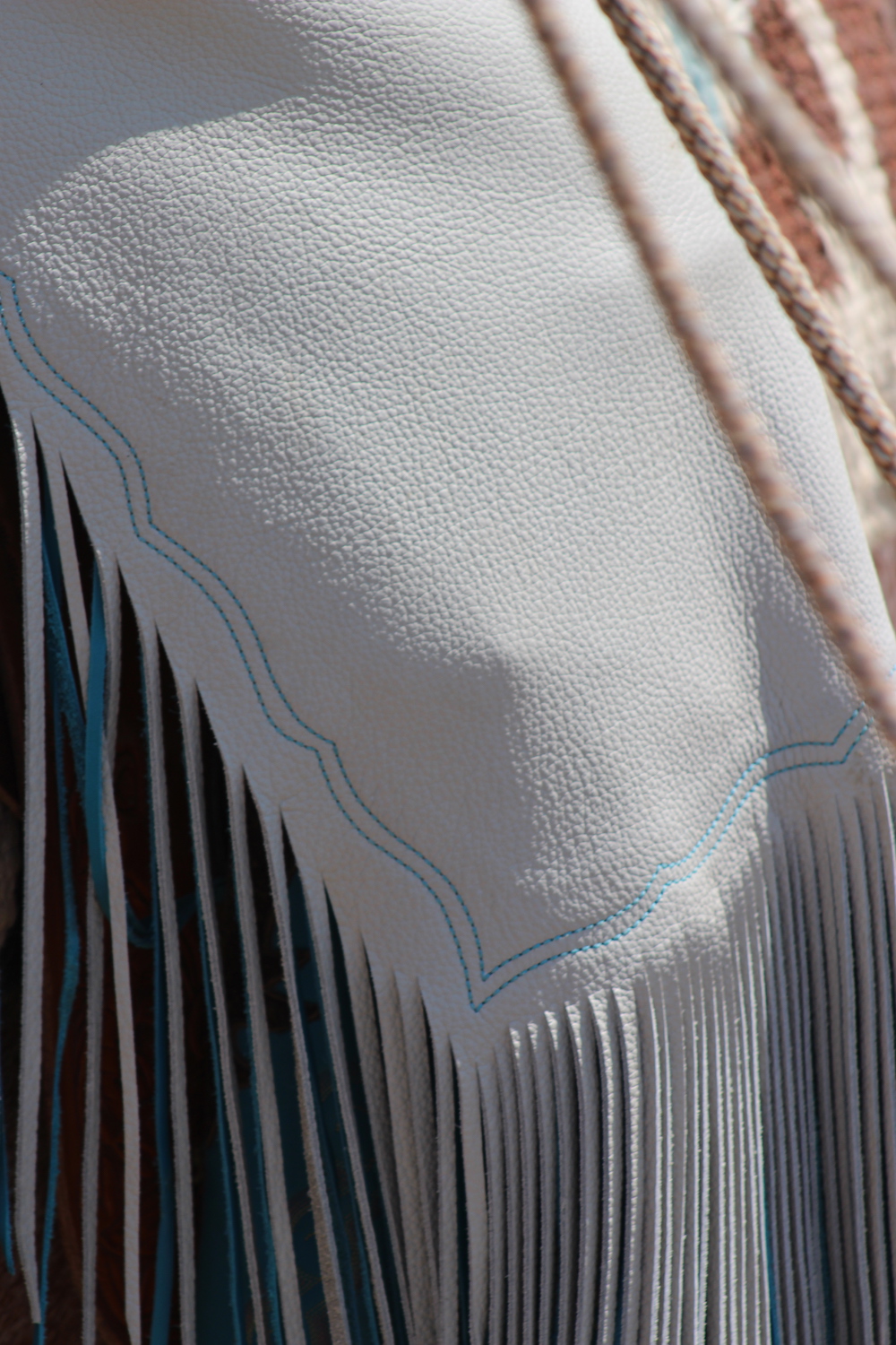

Sorry late to the party. Second on the Cobra 18, they rock and so does the service. Just got back from a show. Several very EXPERIENCED saddlemakers and bootmakers, our neighbors in Vendor Row, were examining Nichole's stitching on belts, purses and leggings and pronounced it "absolutely perfect". They also asked what machine she used and one saddlemaker said "I'm getting one". Some examples from the show:
Thanks, Dave. That is some beautiful stitching. The 18 seems to be the way to go, it's the price that gives me the hiccups. (it'd be easier to justify if I was going to be doing some of the gorgeous work like Nicole is doing.) It's probably the best machine for making things like wallets, too, huh? (Something I want to learn).
Yep she makes a lot of wallets. I remember in another thread you'd said ya were interested in belts too. The 18 sews all our belts too:
