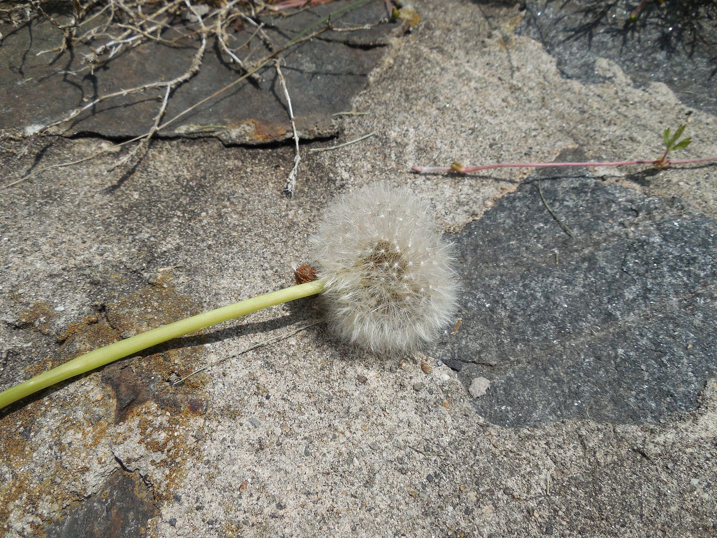

Ok. Using this method you should be able to achieve flames in one strike of your firesteel.
Back yard bushcraft: Dandelion fluff plus dried grass one strike firesteel fire. Much like Cattail fluff Dandelion fluff is a flash over tinder. This means it will easily catch a spark or flame however won't hold it for long. There needs to be something else to catch that flash fire. On the walkway a dandelion with seed fluff.
Fluffy goodness.

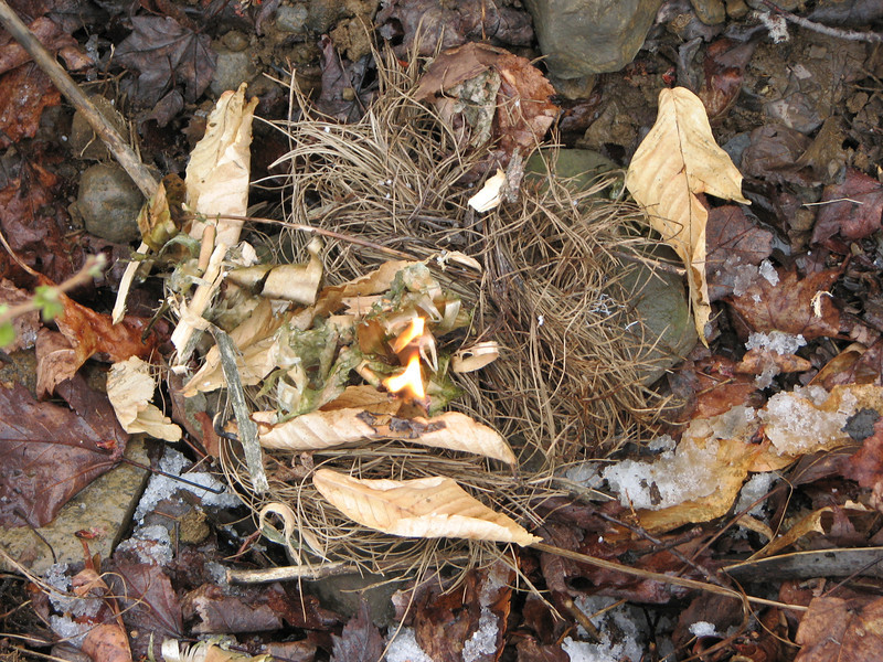

Some dried grass on the edge of the retaining wall. That should be fine to catch the flash fire. On a side note sometimes dry grass works poorly as a tinder bundle.
The Dandelion fluff plus dried grass tinder bundle. I positioned it so the flash over flames would go up catching the top of the tinder bundle.
One strike of the firesteel was enough to ignite the flash over tinder which then set the dried grass in flames.

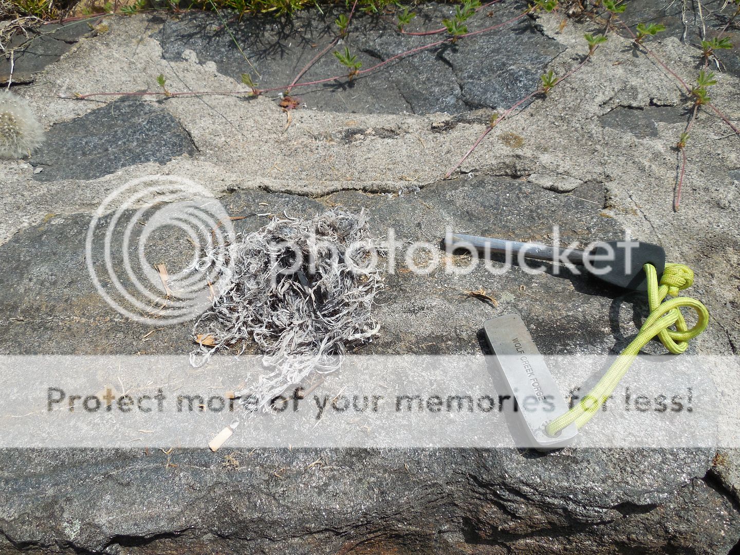

There is a cedar tree in the front yard. Collected the outer bark then fluffed it up. Took three strikes.
Getting flames with a firesteel IMHO no more difficult than with a lighter IF your prep is done right. Cattail fluff is ready right now! Mix it with Birch bark, wood shavings, dry grass etc etc etc. One strike win! Fluffed up cedar bark, dry hanging beech leaves, fine wood shavings and Yellow/White birch bark also work great on their own.

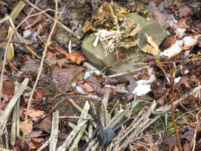

On this trip I was testing out a Sog Force. It had been raining lightly overnight and changed over to snow in the morning.
I place a rock on the ground to insulate the fire from moisture. Sweedish Army Steel
I scrounge around for dry pine needles. Leaves that may be blown into holes at the bottoms of trees and out of the weather. Birch bark cut up small and rubbed even smaller,
I'll cut some curls for secondary fuel, mostly from small dead branches hanging in other trees.
Took a few tries, but it caught,
And grew,
Add sticks, and be happy!
