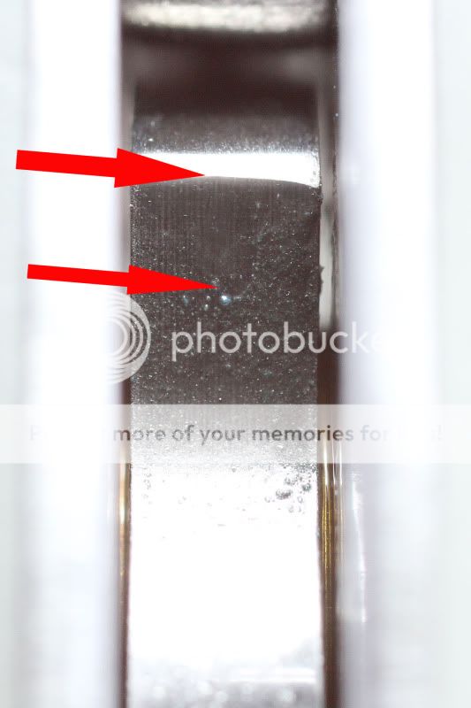

Here are some pics of the area of the tang where the ball engages:
Manix M4 (already seen some heavy use with the original steel ball bearing, recently modded to ceramic):
It's not an easy area to photograph. I have marked with an arrow the contact point from the ball:
Unfortunately, I don't know whether the deformation/wear marks were there before I did the mod.

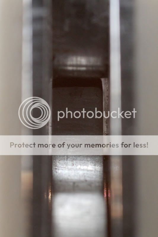

Here are some pics of the same area on an unused (but opened and closed about ten times) Manix 2 Moonglow (CPMS30v blade and standard steel ball bearing lock):
I'll keep an eye on this area of the modded knife and see if there is any discernible change over time.

I am an obsessive flicker, so what does over 10K cycles do for your tang?
Basically nothing. My blade was etched in a mild acid, so you can physically where the ball has been riding, but its not dented, damaged, or prematurely worn at all. If anything actually it looks less worn than the manix 2 I let a steel ball ride on
