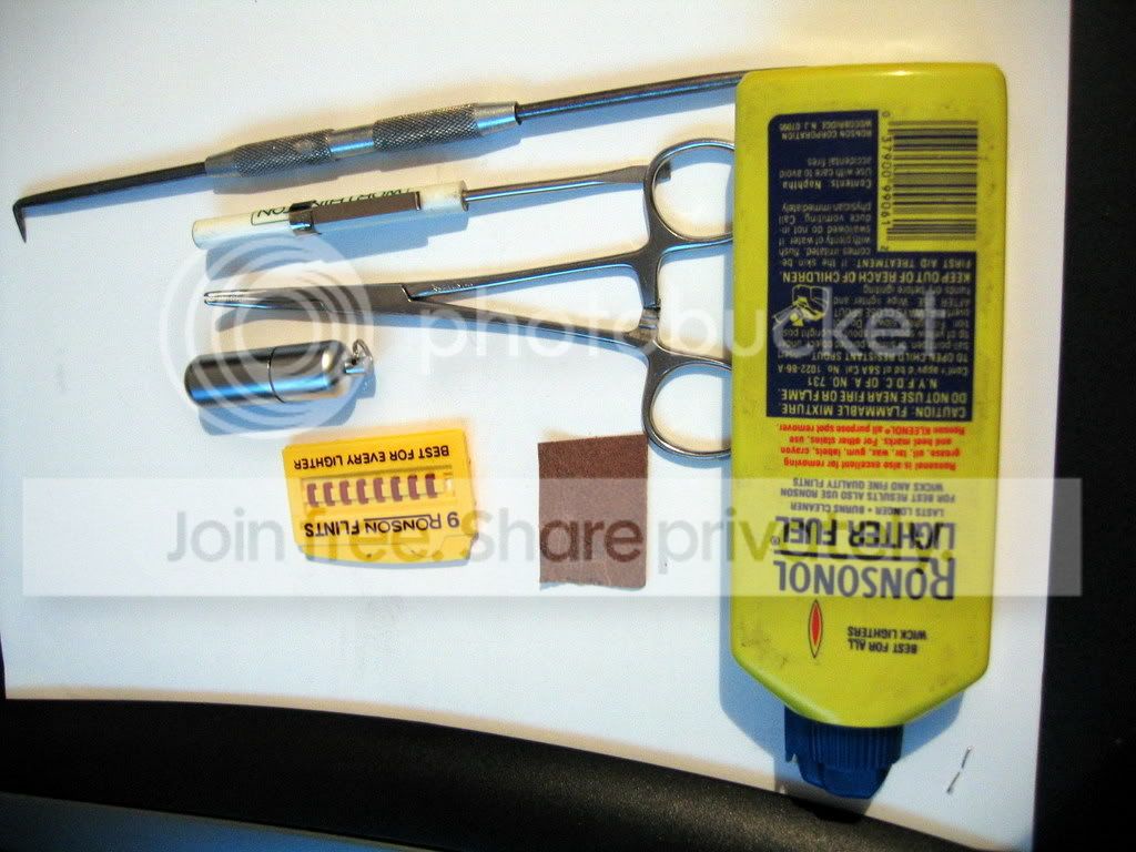

wjzgma I use the eye dropper for the big stainless pill cases (I got at CVS) that holds lighter fluid. The eye dropper is plastic and before I was wasting a lot of fluid refilling the small lighter so I use a small dropper. I have 2 lighters (1 backup) in the one kit with extra flint and 2 big stainless pill cases.

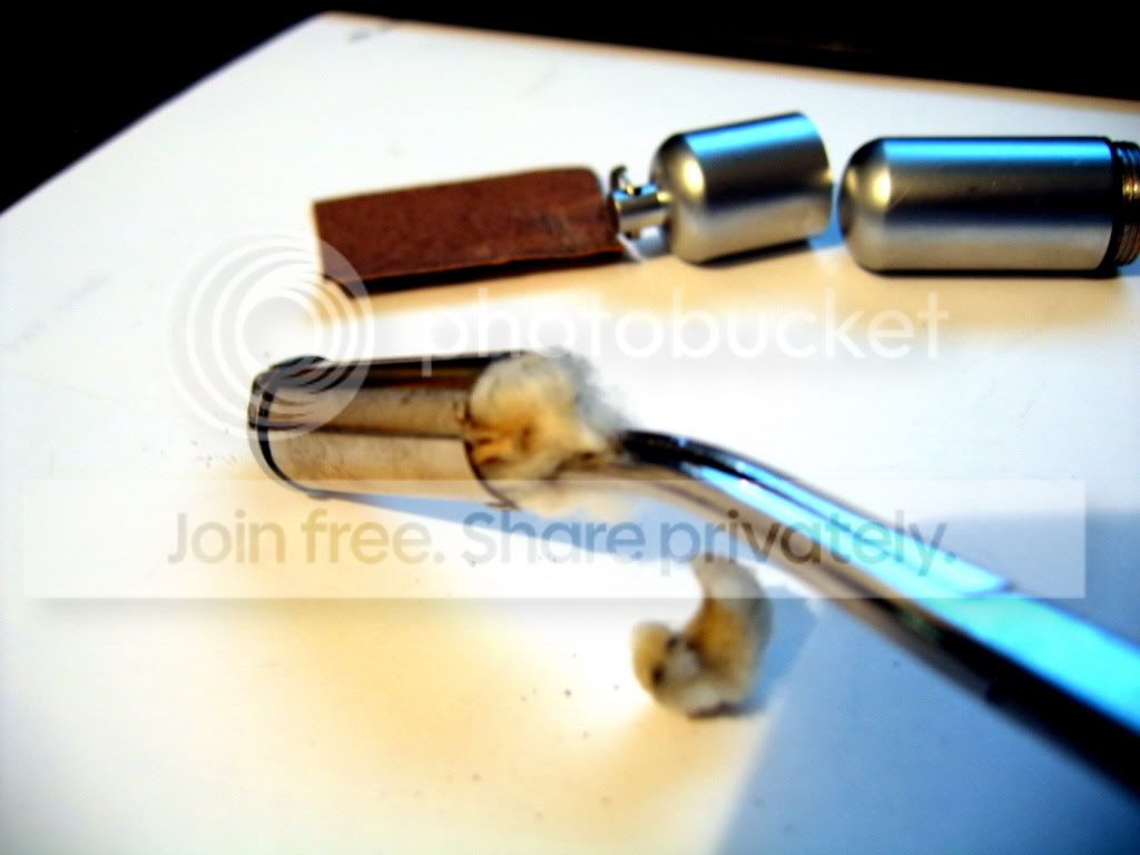

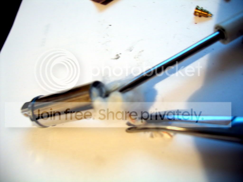

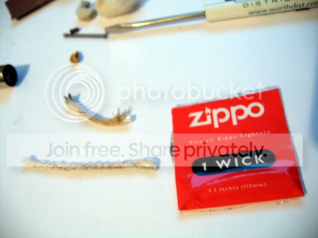

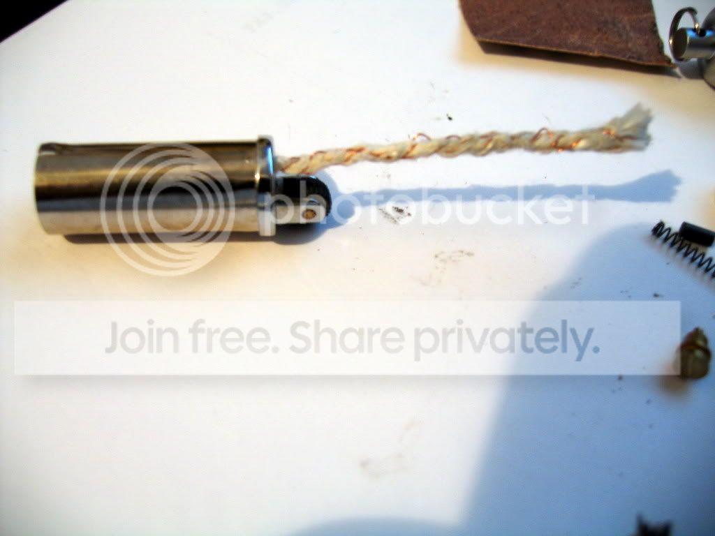

If you put in a zippo wick (from walgreens of walmart), use hemostats to pull the cotton and old wick out, then put the new wick in and hold the bottom with the hemostats at the bottom so when you put the cotton back in the wick doesn't slide up. I cut the wick off at the bottom of the lighter to get the max wicking action. If you don't have the new wick go to the bottom of the lighter, it will seem like you are running out of fuel quickly because it is not wicking up the fluid on the bottom of the lighter. It's really not as hard as I'm making it out to be but it does give a nice flame.

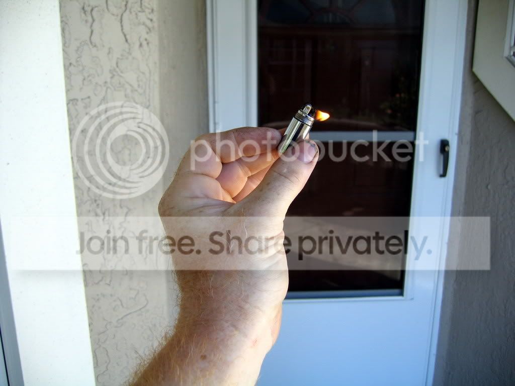

What about wind resistance, this lighter seems to be missing any kind of wind guard like a bic or Zippo Have
I think these look like a better idea than a zippo for a PSK, simply because they seal better, I think I may pick one up.
FLIX, if you don't have a CVS near you try: http://www.medids.com/PILL_PAL.html
EmsRescueGuy, there not very wind resistance, all you have to do is cover your hands or turn your back against the wind, behind a tree or in a hole, etc.. but if you need it in a survival situation there great because if you have them on a keychain and fall out of a boat or in a creek and get to shore it's not effected against water in it's capsule and if you carry a pill fob full of fuel, then you'll have extra fuel if your stranded for long periods of time. It will handle a little wind though...

Gyro5000 thanks for the reply and pics, :thumbup:
I see by your arms that you are also a member of the pale freckled esily sunburned white boy club :D
EmsRescueGuy , your welcome and yes I am one of those step children that many people refer too. I'm glad there's another one here, I had an extra one of these lighters I was upgrading and I'll try to get some pictures of it disassembled tomorrow so everyone can see how easy this one is to repair in the field if needed.

Here's some more pics of upgrading it.

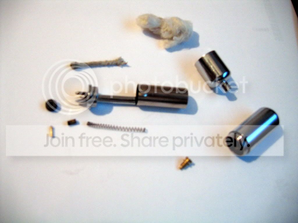

This next picture is a complete breakdown, I would not suggest going this far unless you were rebuilding the entire lighter! This picture shows you the entire breakdown for curiosity.

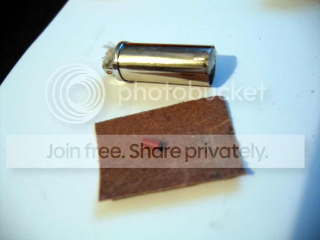

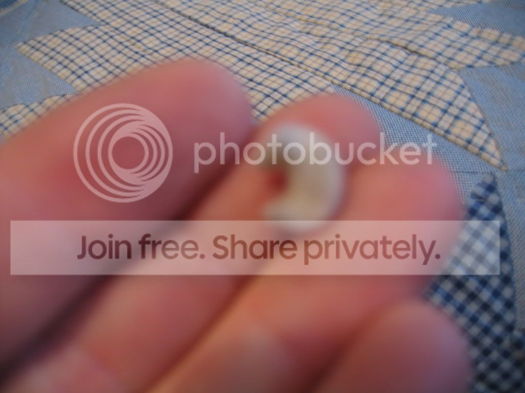

Use normal flint, sand down the sides slightly to fit.
Throw this End Cap away

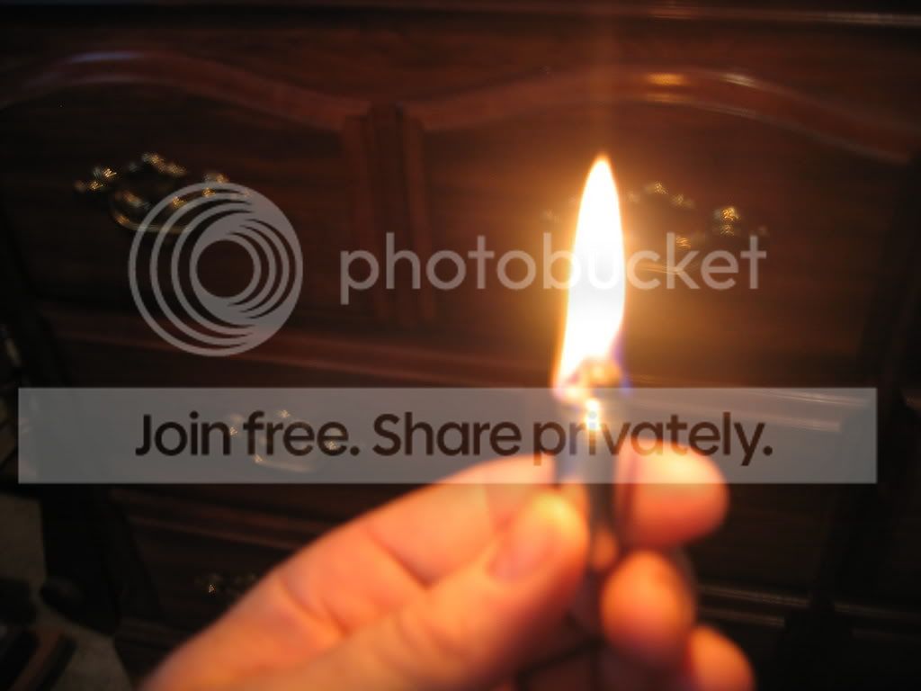

End Results
A real tourdeforce of photos Gyro. Thank you kindly.
