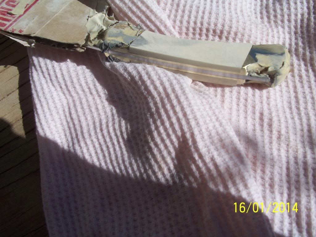

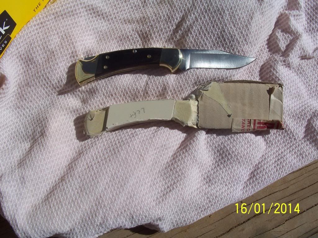

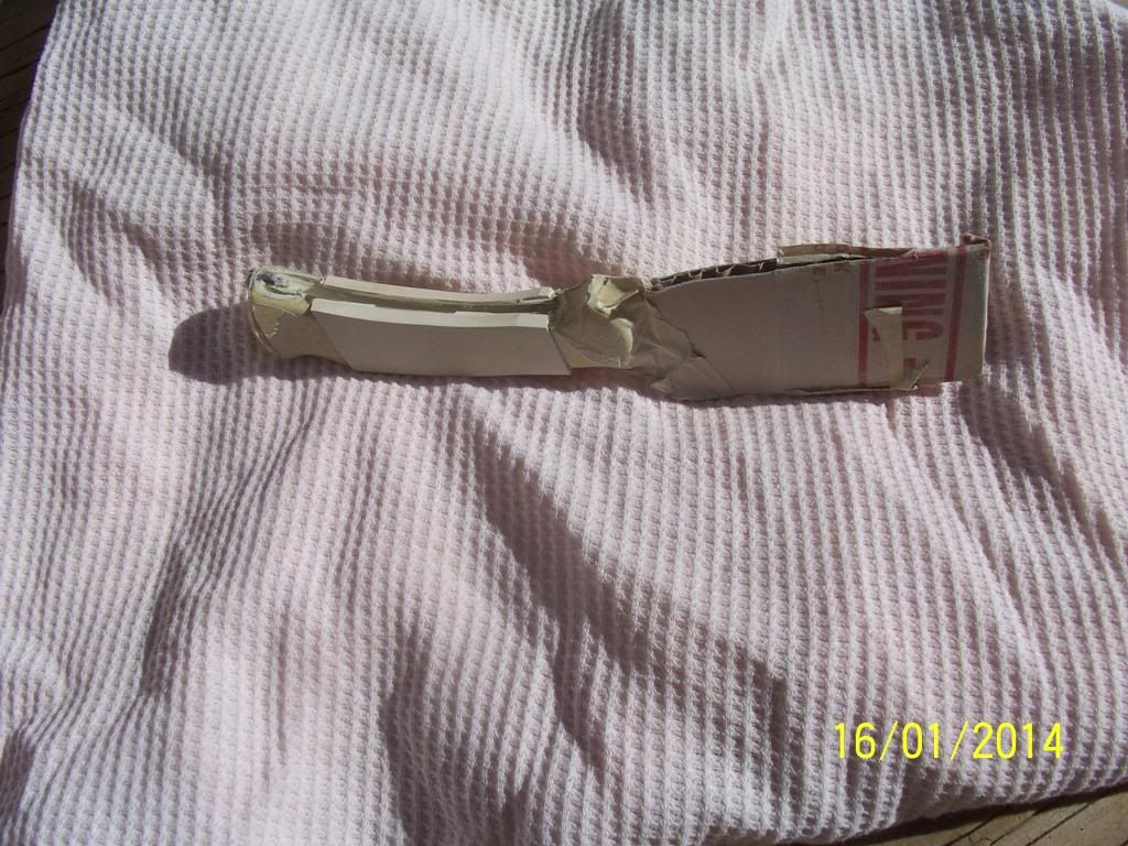

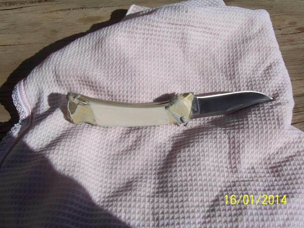

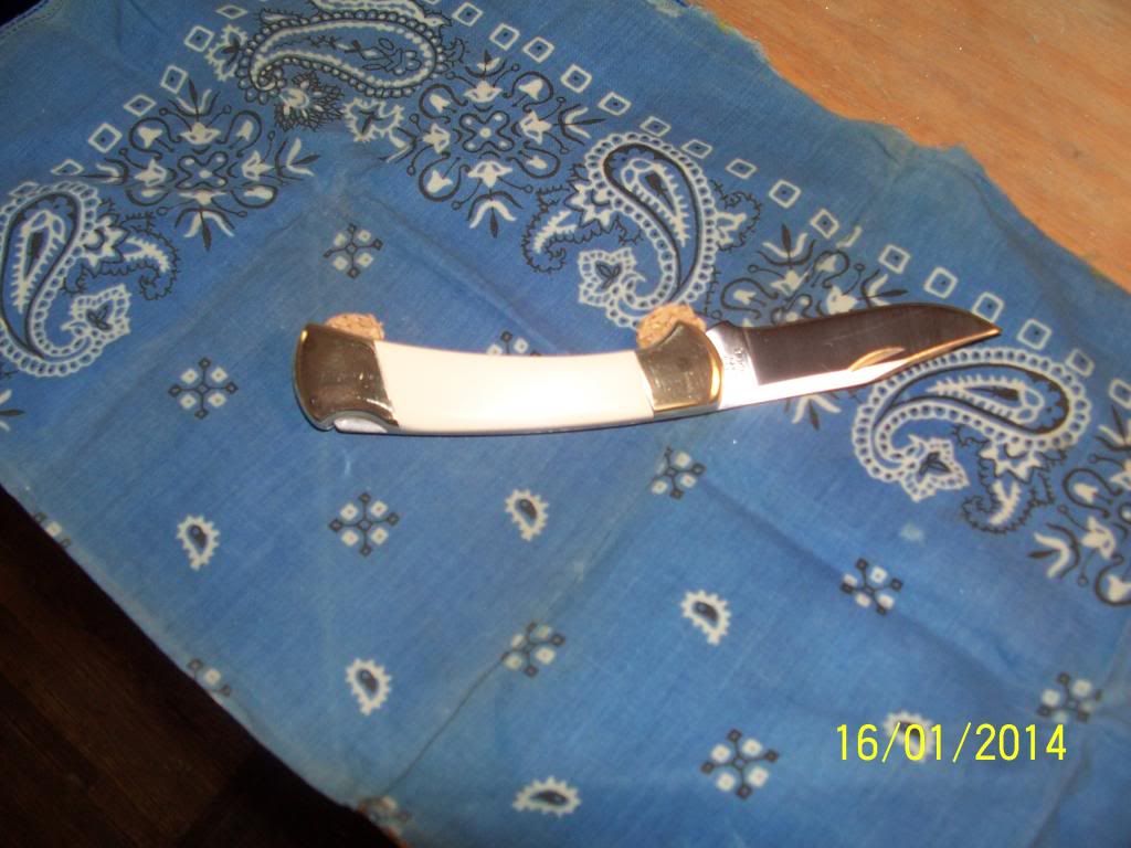

I installed ivory micarta slabs on a standard 112 for some later scrimshaw work. Here's the slabs after the epoxy dried. DM
Outstanding result Desert Dave. Ivory color looks rich on a Buck knife. I applaud you talent and achievement. Was it much trouble preparing the target knife or installing and finishing the inlays?
Anticipating the embellishment to come. Have you settled on a theme? Your smiling face perhaps...
Thank you Oregon. It took me (plus, I don't consider myself to be Fast at it) 2hrs. to remove the original slabs, cut and fit a new pair. Then set in glue to let dry for a day. Then perhaps 6hrs. today for sanding and polishing. So, an 8hr. job. My photos are not as good as some other folks here. Still, it turned out nice. A friend wants his name on it in fancy lettering. Once she gets that on it I'll get you a photo. The 112's have some subtle lines, giving it a classy look. I enjoyed my time doing this. DM
Thank you Chris. My photos don't do it justice. It's a looker. Especially, without pins. Guys who have considered changing a 110 or 112's slabs should do it. The worst you could do is ruin the knife. So what, get another and try again. Some others here have done some nice jobs replacing handles. Give it a try. There's some tricks but its not that hard. DM

ITE, Thank you. The pictures do interrupt progress but I thought, what the heck it will be a different topic for us Buck nuts to discuss. This handle material-- paper, ivory micarta is strong stuff and wears on sandpaper. I wore a dust mask and eye shields as the dust can be a problem when working in an enclosed shop. Not so much when sanding wood. DM
