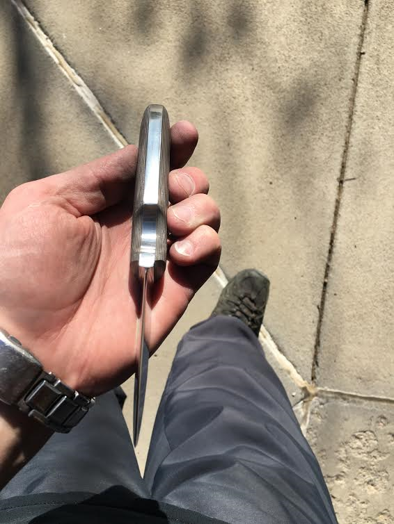

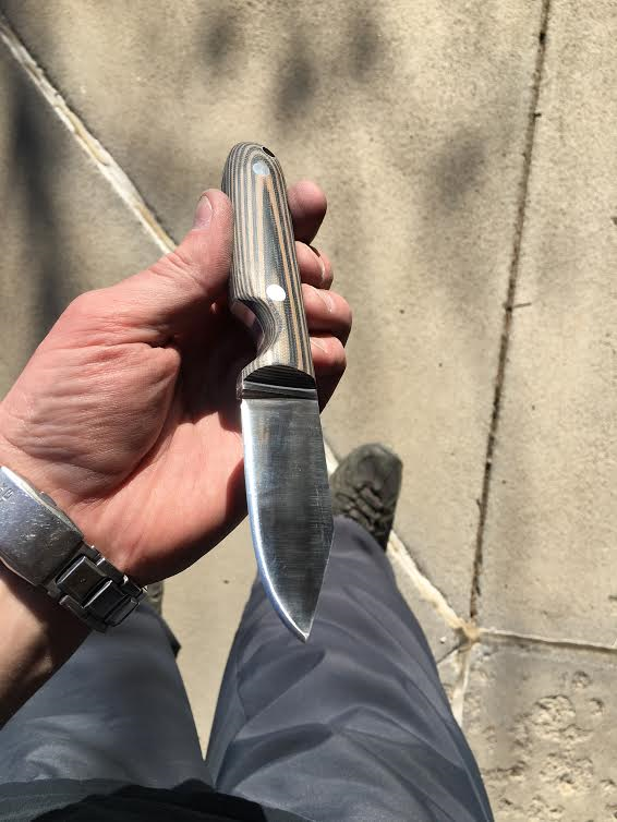

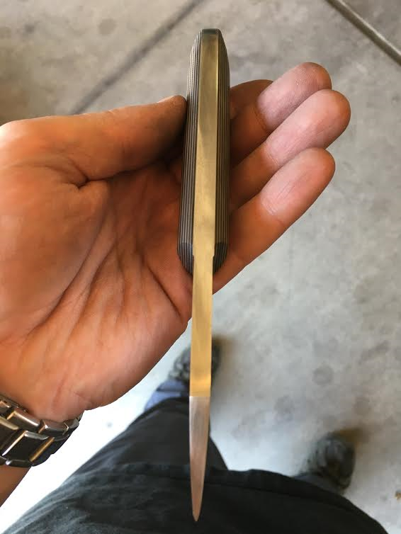

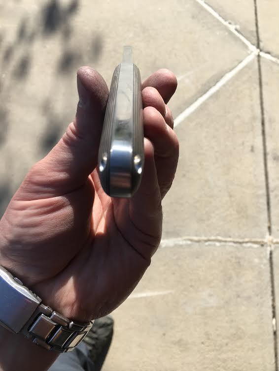

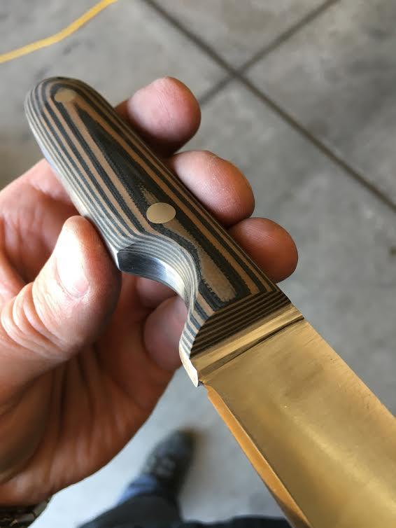

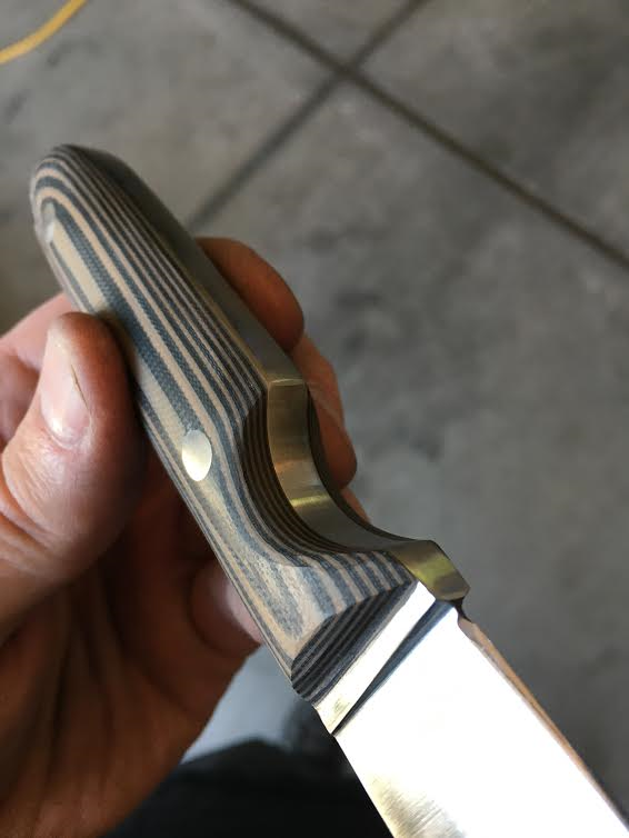

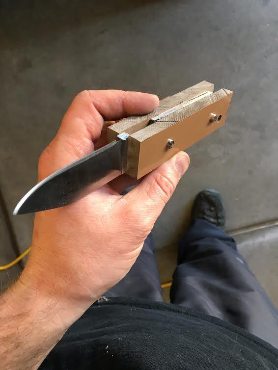

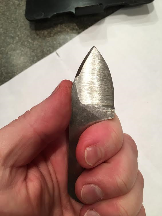

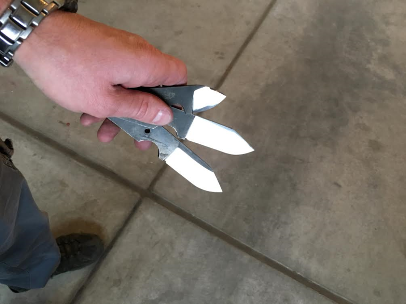

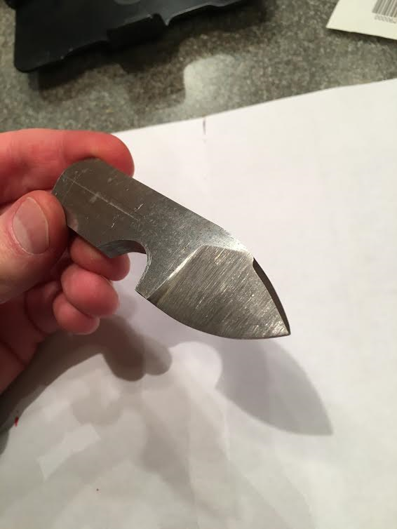

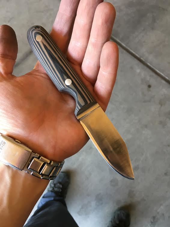

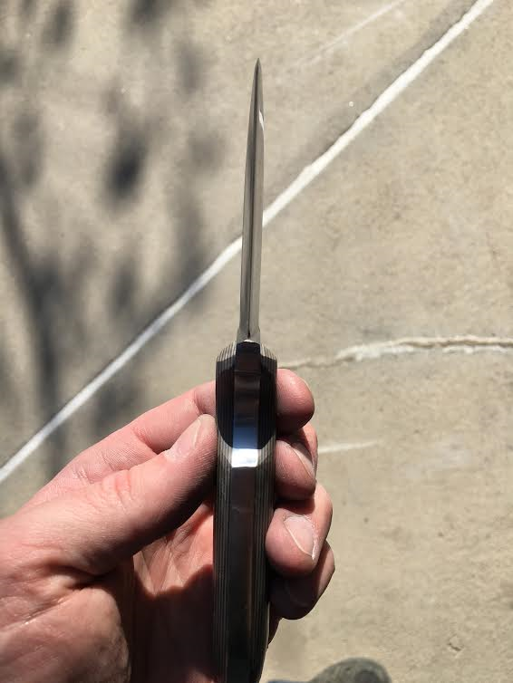

I finally completed my first knife! Took me forever to complete it but I don't do anything fast in life! I have always wanted to make knives and after a friend and fellow knife maker helped give me a push I bought a Northridge Grinder, a drill press and some other tools and finally got started. This one is 1084 and ground, heat treated, tempered and did the G10 handle my self. Working with the G10 scared the s*** out of me ha ha ha! Turned out better then I thought it would. She is a fat over weight pig at only a 3" blade and 1/4" thick hahaha!!!

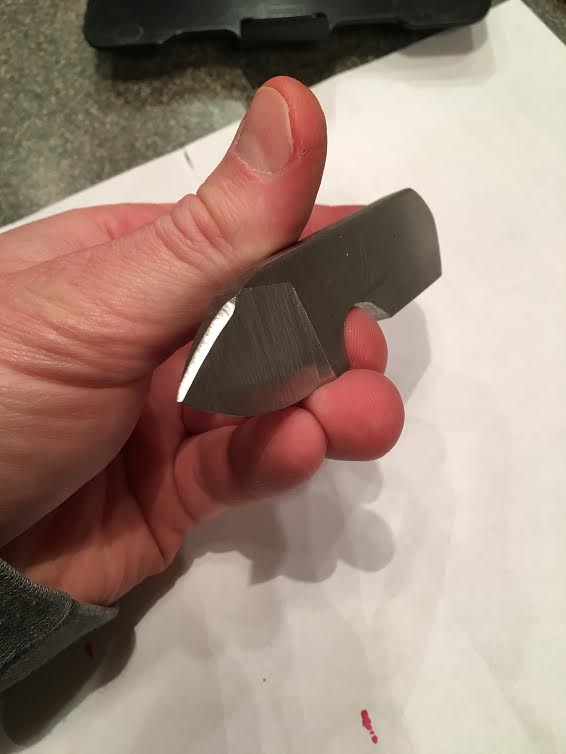

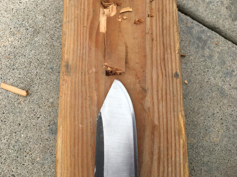

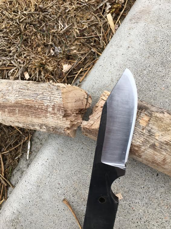

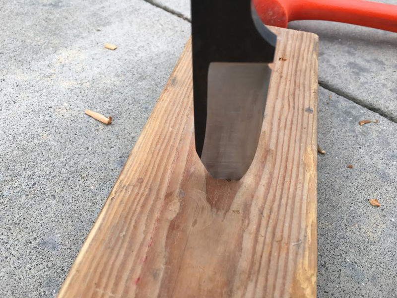

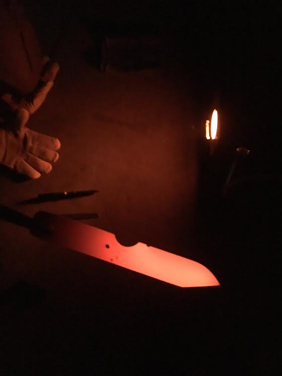

After heat treating it, it seemed extremely hard. Got it to nonmagnetic and about 5-7 seconds longer and quenched in Canola oil. I tempered it for 2 hours at 420 degreese trying for around 59 Rockwell. A good sharp Nicholson file wont touch it and skates right off the steel. I tested by chopping and buttoning through some old, dried seasoned red oak logs/branches. Also hammered into a board and snapped out sideways to test tip strength. All seems well and the steel/edge did not chip, roll or crack. It was still shaving sharp after the tests.
It is far from prefect and I'd appreciate any advice of stuff you see that I could change and improve on. The other knives are the next few I have ground and are waiting for a G10 handle. Thanks!
