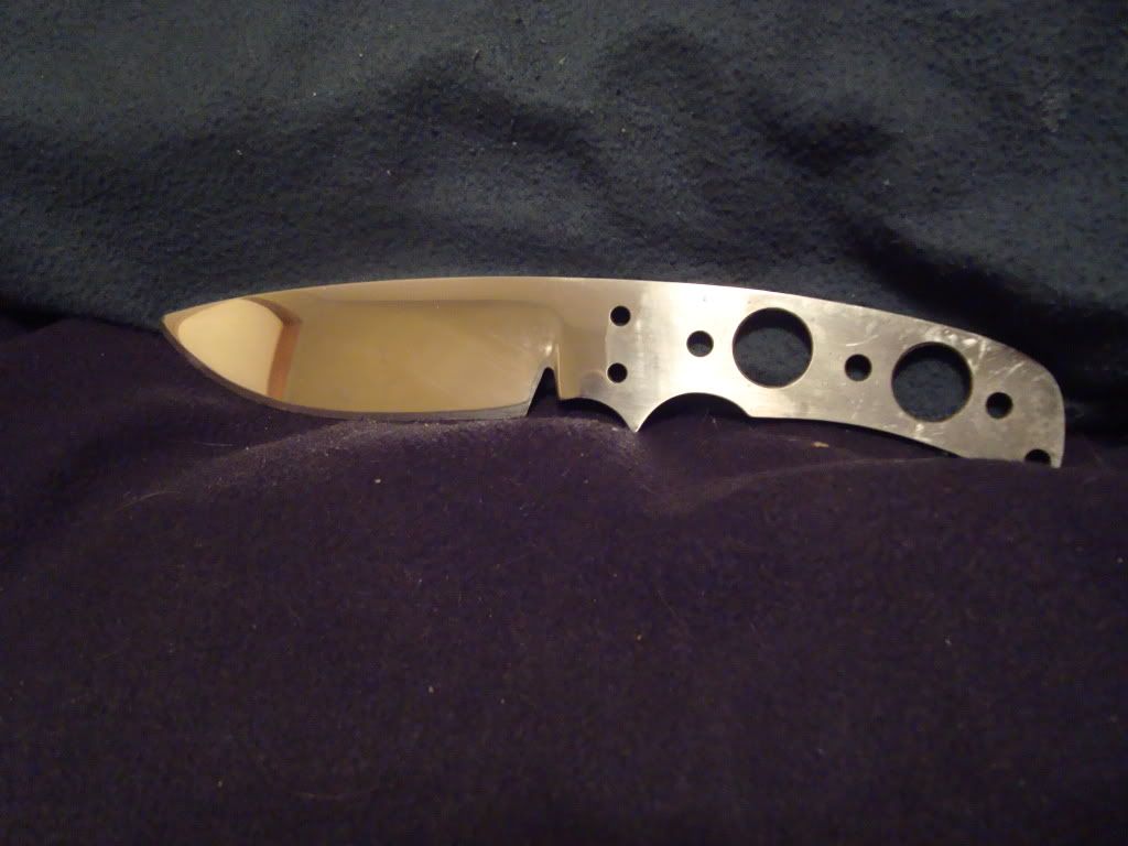

So after a weekend of sanding I finished up at 1500 grit

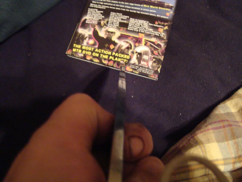

The wet part of my sanding was a 1:1 mixture of water and Pedro's degreaser/bike wash, simplely because it was in a spray bottle on my work bench. It worked amazingly well too. I only went past the 400 grit from the bolster pin holes to the tip. There are light scratches from the 1500 that the camera isnt picking up, what you are seeing is smudge marks that I didn't fully wipe away:o I also sanded the spine and all the edges to the same point
Its not the best picture but you can see the reflection in it. So now its on to polishing out those last few scratches and working on the handle. After that I need to make a sheath. I was going to go with Kydex at the start, even bought a piece to make it, but as the project moved forward I decided that Kydex just wouldn't suit the knife. So leather it is, I will be wet forming it, and either leaving it the natural brown or dying it a deep redish brown to match the scales.
Being that I have made this knife with almost all hand tools I would like to continue with that theme, does anyone have any advice on hand polishing out the last few scratches?

still trying to get a finish on the blade that I am happy with. I am giving up on the hand polishing, it just isnt working for me, The last attempt actually took the finish backwards, so tonight after work I will be running out and getting some 2000 grit paper and take the sanding to that and see if I like it. I really don't want to have to farm out the last step getting the sheen I want.

If you're looking for something to hand polish it you can check out these Stacy sent me some when he sent me my starter package. But he said you can use them until they're shredded and you can get it up to 8000
Thanks Fletch I will be heading to the local 3m/ machine place on monday to see if they have it or can get it. I was also thinking of giving some lapping film a try. So far everything I have tried has just put the scratches in different places but hasnt lessened them
