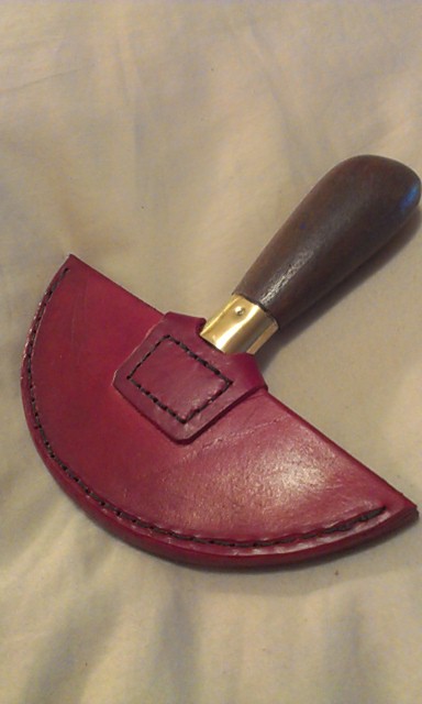

Hey Chris. On mine the handles do swell towards the rear and then taper again last 1/2" or so. I've found this very comfortable. Be careful shaping the handles if you use your grinder, particularly around the front. Those roundknife blades stick out in odd places you aren't use too working on a regular knife. Easy to catch the blade accidently on the belt. Bad things can then happen. On my second batch of roundknives I moved the front of the handle back so that it cleared both points of the blade just for that reason.

I find this handle pretty comfy, if a tad long.
