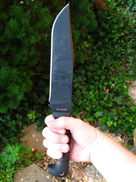

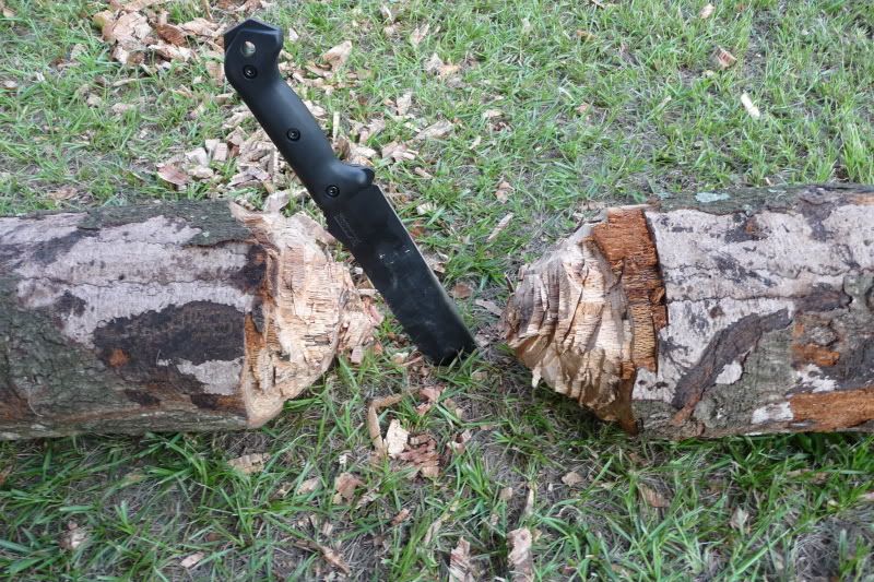

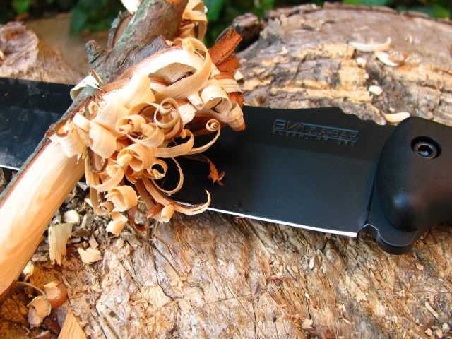

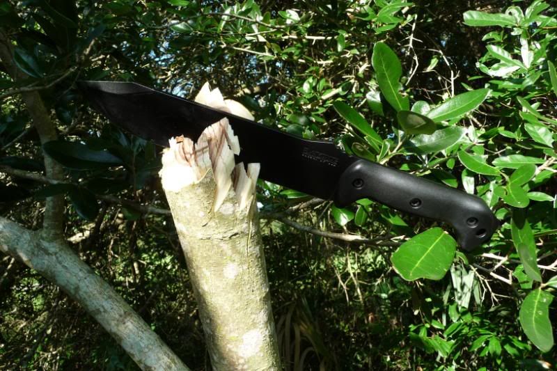

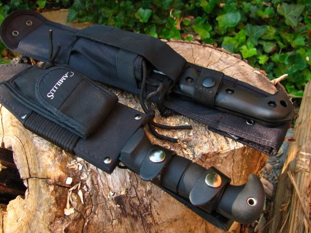

I'll mention a couple differences between these knives.
The BK9 comes with a very thin edge which bites deep when chopping and allows for smooth slicing. I normally like to thin out the factory edge but that is not necessary with the Becker.
I find the Becker's handle to be slippery. I would suggest using a lanyard for more stability and perhaps wrapping the scales with some kind of athletic tape.
Or if you don't mind the additional cost, the optional micarta scales are awesome and turn the Becker from a great knife into a knife that would rival a $300 custom.
The Heavy Bowie does not have as much of a forward weight bias because of the longer clip point design. However, you can use the great pommel design to slide your hand way back on the grip for more power when chopping. The handle is a hard rubber and does not cause hot spots like the softer kraton on the Cold Steel Trailmaster, for instance.
The Heavy Bowie is made in Taiwan while the Becker is made in the U.S.
Both of these knives are winners and you won't go wrong with either one.
