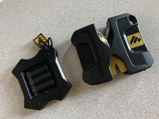

Although I've owned and used all kinds of budget knives in the decades past, I've never really sharpened them. This year I've taken up an interest in higher quality knives and have been enjoying this new interest.
I'm also new to knife sharpening. After going through plenty of reviews, I picked up the following from Worksharp, which each have thousands of positive reviews:
Long story short, I've followed the instructions and although I see "some" improvement, my knives aren't nearly as sharp as the brand new ones I get from Spyderco, Zero Tolerance etc. I've tried doing it over and over, and I do follow the instructions to the tee, but my knives really don't get sharp.
I would like them to be like factory sharp... where I can slice through a paper with ease and no snags. In particular, I have a used 3" XM-18 that gets "a little" sharp, but nowhere near as sharp as my new ZT's or Sypdercos. What can I do??
Any advise is most appreciated -- thank you!
Take those two gadgets and throw them as far as you can, then invest in a set of bench hones (preferably diamond) or one of several guided sharpening systems. The Maintenance, Tinkering and Embellishment forum here is a good place to learn more about sharpening -- do a search. There are several excellent books on sharpening, too -- do a Googlesearch.
You'll get some excellent advice from guys with more experience with sharpening than I do...first thing is ditch the pull throughs they don't work. I've just recently dove deeper into sharpening and finally have it to where the edge gets razor sharp...which took a good bit of practice and patience. What worked for me was a two sided diamond stone and I got a tri-hone with a coarse, medium and fine grit and finally a strop to finish. Its a labor man.....proper angle, proper pressure, when to get the burrs off, do you have more than just a wire edge and getting that nice fine polished sharp as hell edge. I'll start with the diamond stone, 20° angle, work a side til the burr is significant enough to change sides, check the edge till I think its sharp enough to go to the honing stones, once I'm happy with that to the strop. Do a search to get fine details etc....all I can tell you is it's worth the effort you put into it, start with cheaper steels until you get your technique down. Make sure to keep your angle while moving with the edge, that was a tricky part for me to get correct....but man once you can get it right its pretty cool to have that perfect edge nice and razor sharp and you know how to do it yourself. Patience, practice and do your research....lots of good info here from guys who really know their stuff, it helped me through some snags. Good luck!!

Wow, thanks guys.... I take it I should throw these away :D
Somehow spending $15 and taking it to a $400 knife .... doesn't seem to add up. I'm having a difficult time reconciling how thousands of people are giving it 5 star reviews... is it because maybe the vast majority of them are sharpening lower end steel... and perhaps the higher end steel cannot be properly sharpened by these devices?
Either way, I'm going shopping for a real sharpener, and look forward to learning a new skill -- thanks very much to all for the recommendations.
