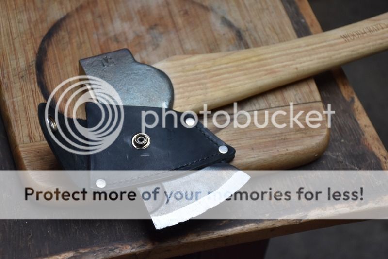

Not a great debut for the new Council Wood-Craft Pack Axe
Here is an example of a working edge I use for frozen oak. The close up was after the work. I cut down the center part way with a chain saw. I allowed this oak to get soaked rain snow and slush. From the top down. From the ground up. And from the sides. Then I waited for it to freeze. You can see the ice in the center. This was a test to test an edge on an unwarmed axe on frozen oak on a below 25° day. It suffered no damage. It also had gone through some abusive splitting. I banged up the handle and drove it into the ice and ground more than once. No damage.

Well, this is where that over-large phantom bevel comes into play. It's the toe and there's not a huge amount of meat up there. I don't want to start my life with this axe by sacrificing some of it.
You make a good point. With so little bit even a few sharpenings will change both the appearance and fucntion of the axe.
Despite the advertising I see no welt in that sheath.
Pretty sure I do. In the photo of the axe going through the stitching you can see that the bit is riding up over the welt. It's just hard to see because of the contrast level and the angle.
Thanks. I see it now. I wonder how the axe got around it. Perhaps it's long on the inside and left a flap for the axe to get into. A couple more rivets might help.
Perhaps the welt wasn't glued, and could use such treatment. Perhaps it was just the weird angle it jostled in the box at. When resting on its side it's going to have the edge drift to the side it's laying on, so that's my guess.
The purpose/function of a welt is to prevent what happened there. It's something I look for in a sheath. Of current sheath makers Weaver seems to include them always. Sheaths from Ben Meadows or Harry Epstein don't have welts.
I have been making my own. It seems that stitching is the highest regarded but I have sheaths that the stitching has worn out. So I have just been glueing with cooper rivets. Maybe all stitching isn't created equal and I should look into it?
This particular failure
could just be a one in 1,000 defect. Obviously these things happen and CT made good on it to the customer's satisfaction.
I would hope that CT examined that sheath after if it was returned to see if it was a defect.

By the same token, put swing any sharp axe with the cover on it, and regardless of if there's a welt or not you'll chop clean through it. We don't necessarily know how much force was placed on it.
As far as a welt preventing such a situation, I'd say that it just greatly minimizes the chance of it--it doesn't make it impossible. What I was getting at is that if the bit is resting on the join of the sheath and welt it can still wedge between and sever the stitching. A welt just makes it much less likely because the form is no longer funneling the edge straight towards the unprotected stitching and by being off center the seams are kept out of the way by the edge's shoulder unless it gets scrunched/twisted somehow.
It's not unheard of to glue, stitch, and rivet.:)
Bob
All of Condor's sheaths use all three. Glued and stitched with riveted stress points.
