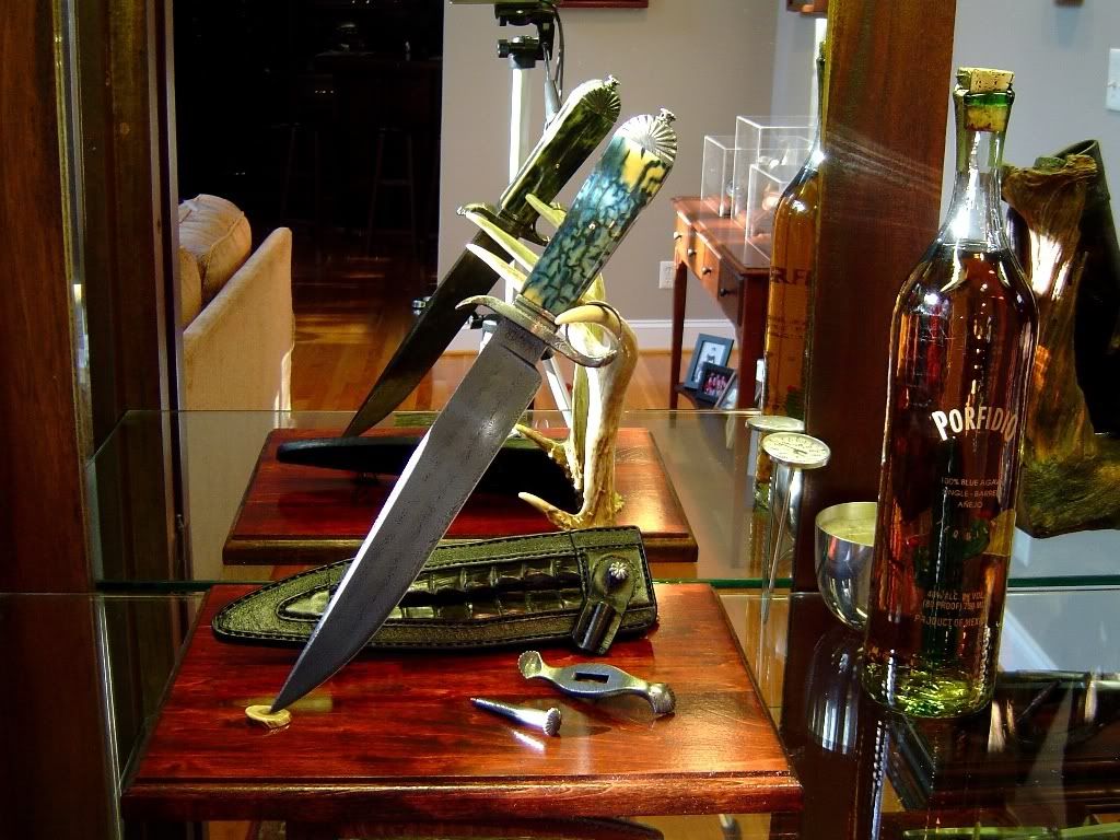

Notice the Jefferson cup filled w/water behind the bottle. A cup that size will evaporate, hydrating the interior of the cabinet, in about 6 weeks.
