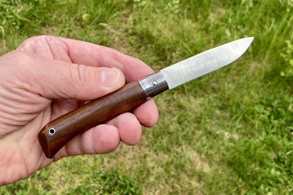

I did both. Dropped the point to the middle of the rounded tip, and sharpened the edge right up to it.Did you sharpen the edge or drop the point? Just wondering how the tip sits in if you just sharpen the edge..
Ever since I was a young boy, this was an incredible treat for me!You ever try to get the very last bit of peanut butter out of the bottom of the jar? That's the one and only time I can think of a blunt tip being superior.
They are stocked in the UK now so one is on its way to me.Well, I can't do anything about the tax, but for the tip I just used this: (remove material with 300 - then finish with 1000)
Then I stropped it on leather and after a very short time it was a pointy tip and a shaving sharp knife.
(I made sure that the upper and lower half of the tip converged at the longest point, in order to not lose any length)
The knife is advertised with 70mm blade length and before the work and after the work it was 71,5mm long
Hope this helps
