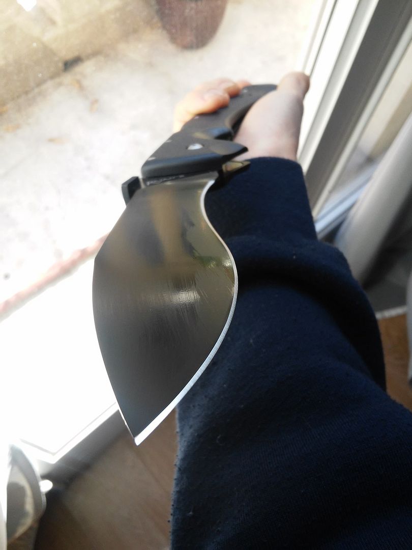

Hi my friends.
I need a quick hint from you CS experts.
How do I know, if it is a Rajah II with AUS8A or the newer BD1 steel?
Are there any differences in appearance?
Does the Package helps?
The Barcode says this: X0004VTG4T
Thanks in advance!:thumbup:

The original Rajah 2's were bead blasted, but then they released a stonewashed version of it before the BD-1 was announced, which kept the stonewash.
Okay, so I guess there's no way to find out a 100 percent, because there are unmarked stonewashed blades of both steels available.
