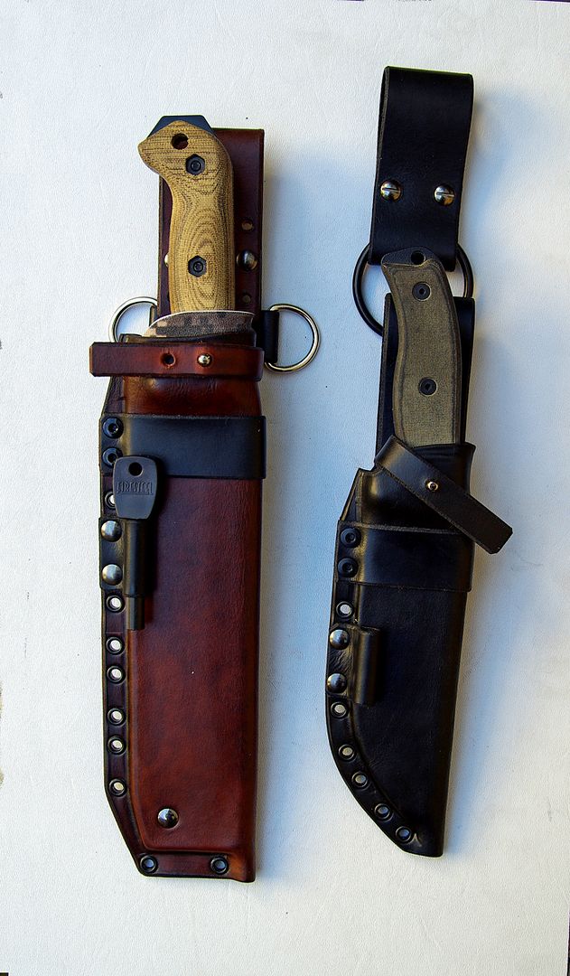

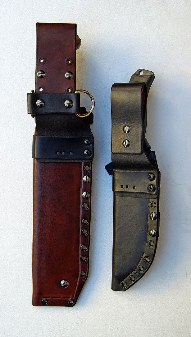

I recently made this one for a BK-9
It has a removable kydex liner (that could be cleaned out) inside a pouch made of halftanned leather.
Halftanned leather has a core of rawhide, and is therefore much harder to cut or puncture and is extremely water resistent once deep waxed.
a drainage hole at the bottom.
a removable baldric attachement.
the kydex backplate takes a leather droploop or a teklok
the teklok could also be mounted directly onto the pouch in 3 different positions.
the retentionstrap is shown in the fixed 'folded away' position, but actually works as a retentionstrap. it pivots around a rivet.
I hope you like it.
