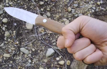

What is the perfect knife? For years I have pondered this. I have had many discussions and debates over features and manufacturers. I have promoted certain blades and dismissed many gimmicks and gadget-like blades. Throughout it all, I have remained true to certain criteria. It was with these specifications, I started to determine the dimensions and features of the Polaris. Taking my current favorite carry blades and those from the past that served me well, I unscientifically measured and charted all the dimensions, blade shapes, and features. Averages were determined and plenty of rough sketches were made. I never planned on reinventing the wheel nor will I even pretend or attempt to say I have since deep down I believe I havent. There are only so many ways a blade can be made. The Polaris pays homage to many classic designs. It just happens to embody exactly what I look for in a basic utilitarian belt knife. It may not work for everyone but I know from my experience and time behind a blade, it works for me.
The basic specifications for the Polaris are:
Tool-steel blade: A2 preferred but 01 works well too
Thickness: 5/32
Width: 1
Blade Length: 3.75 sharpened (4 from tip to handle slabs)
Blade Design: Spearpoint
Handle: 4.25 overall with 3/8 Micarta handle slabs
Edge: Flat and Convex Gossman Grind
Overall Length: 8.25
Misc. Notes: Hard 90 degree spine for ferro rod scraping. Multiple holes drilled in handle to move balance point forward and reduce weight.
I will never say this one will do it all. Ideally, this will round out a trio of tools including a small multi function tool (Swiss Army Knife or Multi-tool) and larger chopping tool like an axe or big blade( I routinely carried this knife with my Gransfors Bruks Small Forest Axe and found no task too big or small.) The purpose of this blade is to have it on you at all times. It isnt too small to limit cutting tasks and it isnt too large to inhibit constant carry on the belt, slung around the body or worn around the neck. Weight reduction was a factor in the design and that is why the tang has many holes drilled through it. As many as possible in my opinion without weakening the tang to a point I would be concerned with. I have used many skeletonized tang knives with varying degrees of material removed and never had an issue with the strength. Still, I wanted to err on the side of caution with the holes drilled.

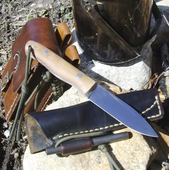

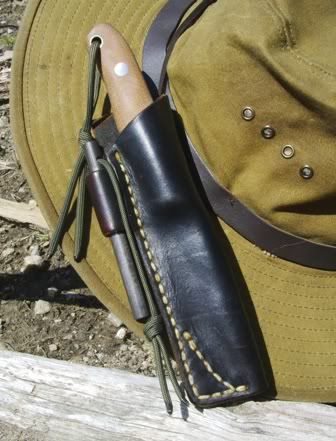

The expression, fits like a glove, sums up my feelings towards the Polaris Field Knife. I received the blade from Scott Gossman and immediately had Greg Haugh of Lonerider Custom Grips handle it for me. Scott is pretty busy and I didnt want to bother him to make the handles and sheath. I really wanted the blade NOW and was too impatient to wait. Once I had the blade back from Greg (handled in natural micarta) I made a quick sheath for it and I was ready to evaluate its performance.

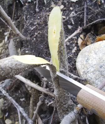

One of the first tests was edge retention. From whittling projects, to opening packages to food prep in the kitchen, the blades edge was unaffected. I used the blade regularly to cut small saplings by bending the sapling and cutting against the grain. The shaving sharp edge cut right through small saplings starting to grow in and choking larger more mature trees. Scotts proprietary grinding technique of mostly flat grinding with a convex finish is really something Ive learned to appreciate. The edge was touched up from time to time with black and then green stropping compound but it never needed the sandpaper and mouse pad treatment.

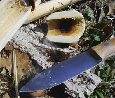

From time to time I tested the tip strength. I like the spearpoint for tip drilling and I used the tip for removing birch bark for bark containers and for starting the initial depressions in bow drill sets. I also hammered the tip into wood from time to time to practice one-handed firesteel fire starting. To really stress it, I drilled into hardwood to start lanyard hole on a project for an upcoming magazine article. I later drilled out the main smaller diameter part of the lanyard hole with a powerdrill. Tip drilling isnt done all the time but from time to time you may need to do it. Rest assured, the Polaris can handle it.

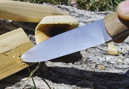

For finer carving and a choked up grip, the blade feels like an oversized but substantial paring knife. Using the blade to blunt the tip of bow drill spindles, I felt like I was using my kitchen knife to trim the top off of vegetable or piece of fruit. The handle contour I requested from Lone Rider Grips puts a lot of material up front where the best purchase on the knife can be made. Being round and free of hot spots (ridges, checkering etc) the handle is very comfortable in extended use in this position.
