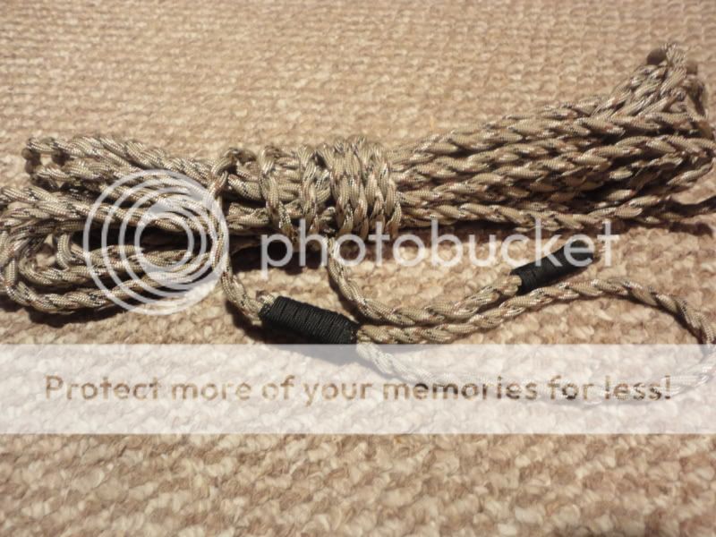

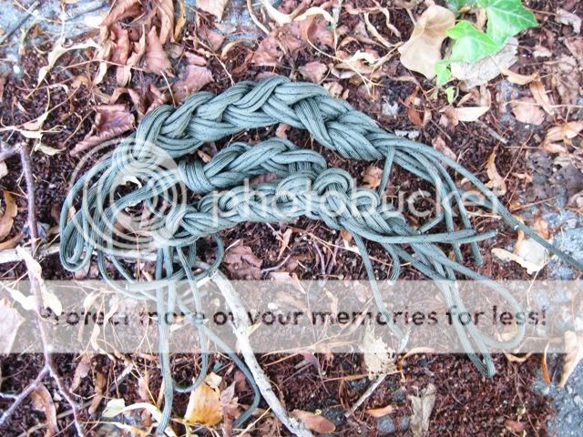

My ridgeline is a 27 ft 2 strand twist of 550 with a whipped eye. I then carry 6 8ft lines for tent stakes etc. This covers a ton of set ups. My tarp is a 10x10.
Ridgeline
I also carry some other lengths in a seperate kit for cordage. I love pre cutting lengths of cordage rather then cutting off lengths here and there. Orginized and less wastefull.
Nice, Jake. The knots hold well with the twisted line?
I have 50ft of paracord I can use for a ridgeline. Sounds like I should be pretty well set between that and 6 x 8.3' lengths of triptease.
Oh yeah, that will set ya up good bro.

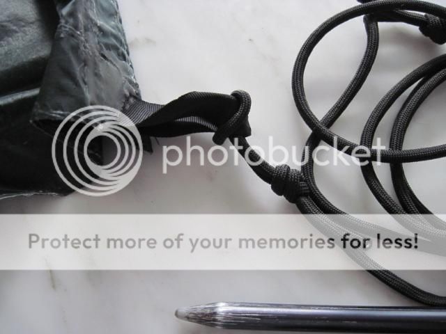

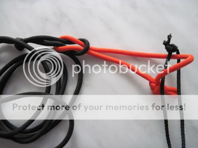

Yeah. Ive only played with the twisted one a couple times. I ran the running end around the tree and through the eye. Finish the other end with a taughtline hitch. I tension the tarp with a twig through the loops on the tarp under the line. Then I can tension the tarp seperate from the ridgeline. Knots hold very good. The whipped eye is whipped under the paracord with waxed linen thread, then whipped again with paracord sheathing. I dont think it makes it stronger, but it might. With the waxed linen, I doubt seriously that I needed it.
These are IAwoodsmens pics, but they do better at what im sayin then me.
Heres another of a girth hitch. I use this for tying out from the loops to the tent stakes.

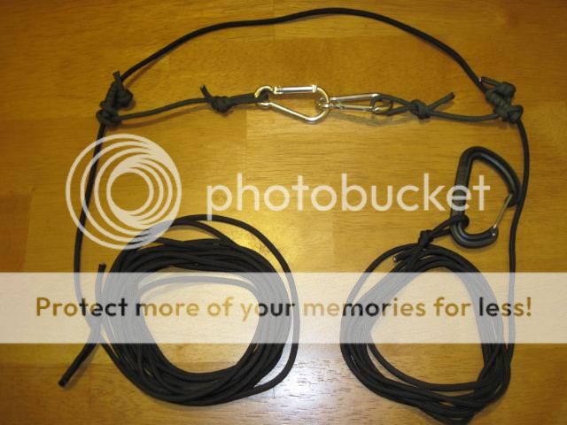

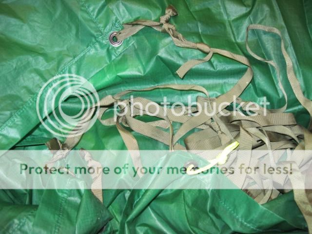

This is a good thread as pre setup tarp lines make all the difference for a fast/tight pitch. In fact having everything ready to go has allowed me to beat the rain a few times. The first thing I setup is my ridgeline which also works for tarps pitches that don't employ a ridgeline like the lean-to.

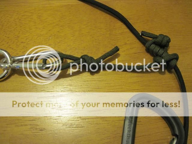

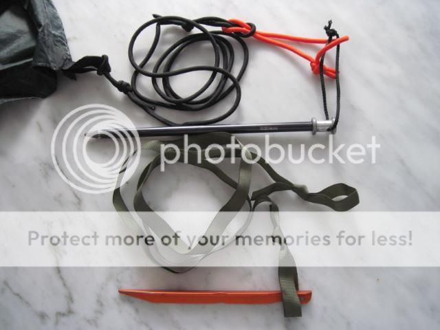

I use a friction knots so the tarp can be adjusted along the line without the need to tie anything. I don’t like to tie knots in the field and the whole setup often requires one (sometimes none) to pitch a tarp. The bineers are used for the ridgeline/tarp and main support pole/tree/whatever.
I use loops to connect the tie-offs. There are adjustable knots etc methods for the lines but I stopped using them as the loops work just fine.
I like to use UL webbing over paracord most of the times as it won’t tangle so can be tossing into my pack on the fly and it won’t come back to haunt me as the rain is falling. Crazy strong stuff but only use it for the tie-offs as not sure a friction knot would slide on it.
As for the lengths of everything the OP is going to have to work that out for himself. I wouldn’t go shorter than 6 feet with pre looped ends for the tie-offs.

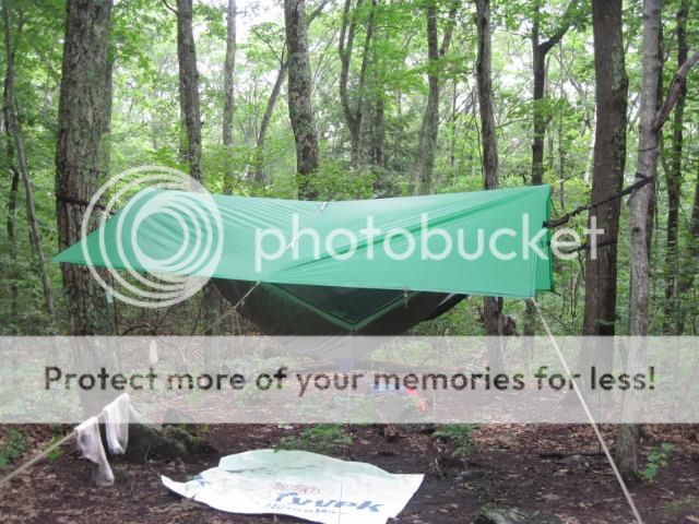

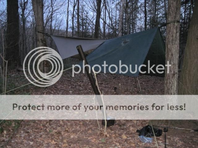

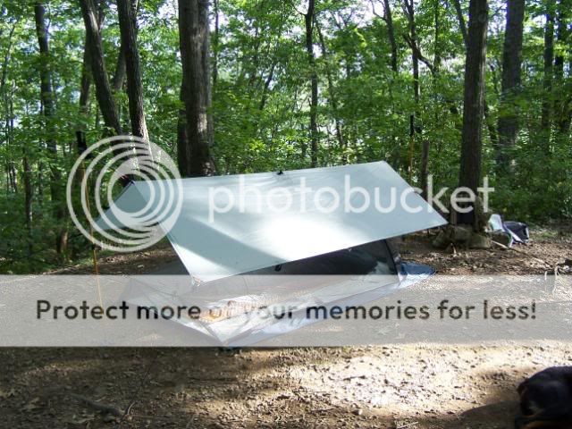

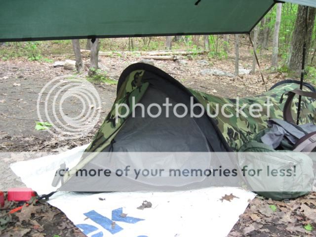

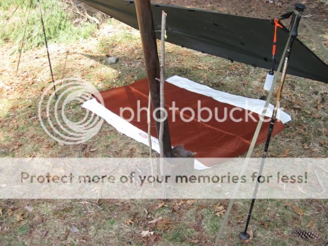

Some photos of tarp setups. One thing about tarp camping is no two setups are the 100% the same. On a side note packing a Silnylon poncho with tri-offs is one of the best gear items going in my view. So much goodness at so little weight and bulk.
