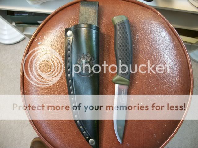

Here is a Mora. A little more typical but not as good a picture. That one and only grind you see goes all the way to the edge. This is the quintessential scandi grind knife.

As others said scandis are incredibly easy to sharpen, you just need to lay the bevel flat on the stone. Very easy to maintain the angle freehand compared to most other grinds.
