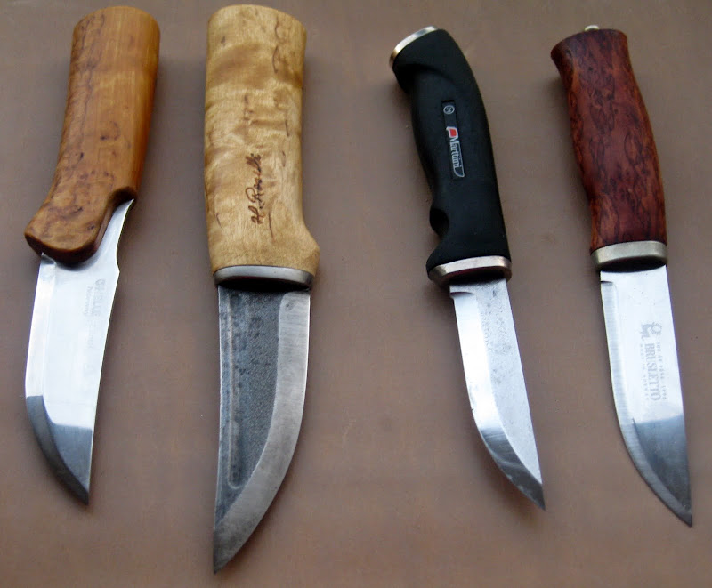

I've also had my eye on the Roselli Grandfather, as in HoosierQ's picture.
Get the knife like the roselli carperter "UHC."
What a beastly scandi knife. They have a small secondary bevel, but it's not hard at all to grind them to zero bevel/convex them.
I'm just not enough of a metalurgist and/or not an expert sharpener to figure out why these knives are sharper even than the Moras.
Once again, it's back to the "done right" thing. Your helle may seem a hair superior to some Moras because perhaps the steel used by Helle is of higher quality, perhaps the angle is a bit different... maybe the heat-treat has a little more quality control. Which, of course, is saying a lot about Helle, because Moras are incredible for their cost. Small bits of attention really make a world of difference with scandi's.

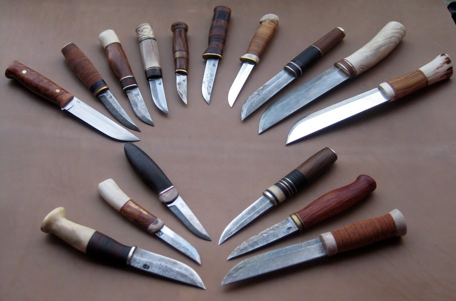

For that guy who wanted a few pics, I got a few here.
Yeah I almost pulled the trigger on one of those a while ago, really nice knives.
Cool pics of that Spyerco, 5.56. Very unique with those black scales. :thumbup:

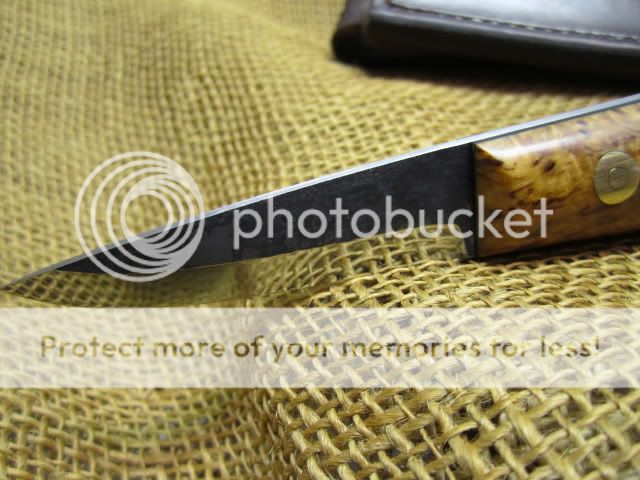

Of the Mora/scandis I have, unless it's dedicated to woodcarving, I've generally used a secondary bevel or convexed the edge.

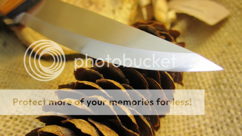

Seems like most blades of this style are ground with a bevel in the 10 degree range, per side. How does a knife like this compare to one with say a full flat grind and a 10 deg/side secondary bevel? I presume it would be weaker, but cut better and sharpen faster, though I don't have any full flat grind knives to try this out on. Would it be too weak work in wood like a Mora?

My Moras are regrind either full flat or full convex.
IME this is great improvement as now I can actually sharpen them in the field and they cut much better this way.
In fact I think that scandi grind is half finished knife.
If the final edge angle is the same, then the scandi grind will be stronger. The primary grind is more acute, with less metal above the edge bevel. The scandi would require more force to push through thicker material, again because it has a more obtuse grind higher up the height of the blade. Cutting ability at the very edge would be identical since the geometry immediately above the edge is identical. Sharpening a scandi requires removing metal from a larger surface, but also requires less effort to control the angle. Speed is going to vary with the user and no definite trend.
