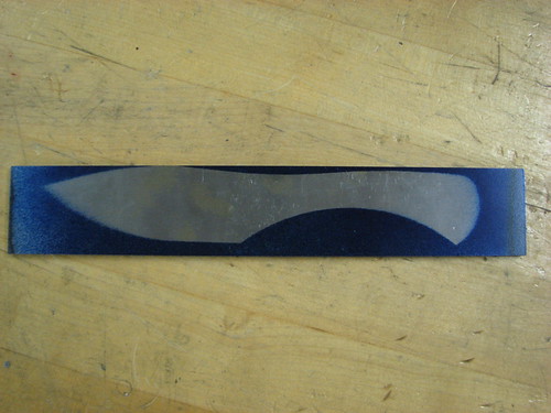

Raw steel marked with the outline of the blade. The blade is 3.5" and the handle is 4". Max blade height is 1.25"

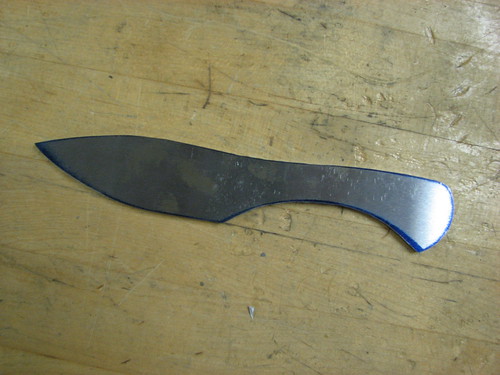

The basic shape ground out. Note that I left a little more material at the butt than the original sketch/layout called for, but it feels great in the hand.

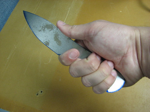

Here is a shot with the blade in my hand for some size reference.
Altogether, I'm pleased with my progress so far, though limited. Right now, I'm trying to decide what type of edge to put on it. Any suggestions for the beginner here? I'm thinking a flat or scandi grind would be the easiest, since the grind is a constant angle. Convex seems more difficult; however, I could also see how it could be more forgiving as well. Any thoughts or suggestions for how I should proceed from here? Whatever I decide, I'm planning to rough the grind in before heat treat and finish from there. As of right now, the handle is planned to be green micarta with a red liner.

What you did with the layout fluid is interesting, but it robbed you of having a scribed line which is very valuable when following a pattern. As you grind to shape, the scribed line disappears, letting you know you are exactly where you need to be. Thats how I can repeat my designs so easily.

Thanks! I sprayed the outline of the pattern rather than tracing the pattern at the suggestion of a colleague at work. It didn't work out as well as I had planned. If you look closely, you can see the edge is very crisp at the middle of the blade (where the pattern was held down), but somewhat fuzzy at the ends (where it wasn't held down). I'm only planning to make one of these, so repeatability isn't really an issue for me at this point, but in the future, I think I'll use the method you've suggested.
