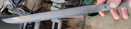

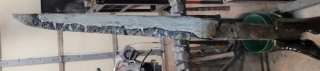

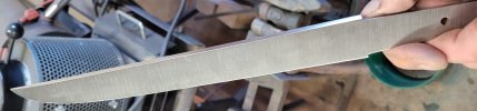

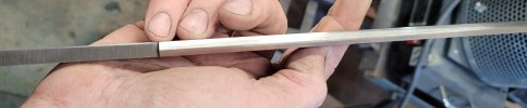

I started the pictures just before heat treat and as I write this the only steps left are the ito wrap and a final polish.

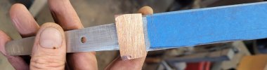

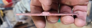

Making the habaki. i actually had to do this twice. The first time I got the finished shape wrong. The habaki has to taper in two directions to function properly with the handle and the saya.
I've seen a few different build techniques but I decided that it was best to do it the traditional way a forge the shape with a thick central ridge.
There was still some final fitting needed after these steps so everything flowed together correctly

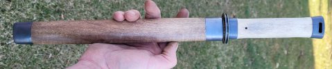

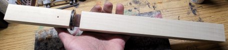

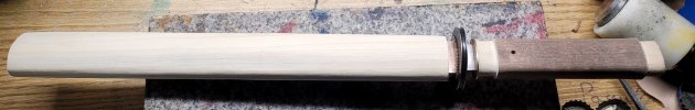

Starting the wood parts tsuka and saya. I am saving the fuchi or bottom spacer for after the handle is fit. It will provide the offset so that the mekugi peg drives the handle forward securing everything. Poplar was used for these parts.
To make these parts I needed some saya nomi chisels. I ended up just getting some regular chisels from the hardware store and reshaping them. I clamped the cutting edge of the chisel between aluminium plates when I heated it up to preserve the heat treat. They ended up working very well but I think I will forge some from scratch later on just so I have an authentic set.
To do it properly the tang and blade are not seated in the center of the wood pieces. One side is carved deeper so that the entire metal parts sits down into the carved area keeping the pressure off of the glue joint. I have a photo of the handle opening to show how much deeper it is carved on one side. The little notch at the blade tip in the saya is to collect an extra oil that may be on the blade.

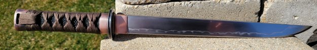

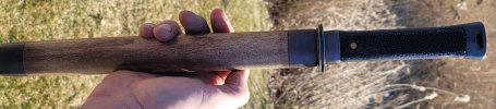

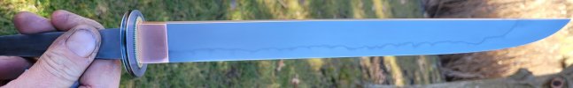

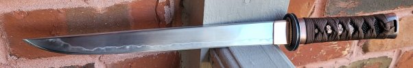

I forgot to take pictures making the copper pieces for the tsuka and saya. They are all made from brazed copper treated with liver of sulpher for the dark patina. The tube for the ito wrap on the tskua end cap is built into the cap I messed around with the removable pieces and decided that I liked a permanently brazed tube more.
I read that the Japanese sword smiths always sign and date the tang so I did that as well and put my makers mark under the tsuba.

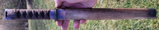

At this point the ray skin is on and all that is left is to wrap the handle and menuki. I should be able to get to that by the weekend and will get an update posted with it finished.

Is the tang pin visible / going through the ray skin for disassembly purposes ? Meaning this is take-apart ?
Thank you. Yes it is a bamboo pin called a mekugi. There is a 1/16" offset so the pin pushes the handle tight into position. If you knock the pin out everything can come apart down to the bare blade. The guard or tsuba is fit so tight that it takes a little persuasion with a rubber mallet to get it off. The traditional Japanese blades were maintained and kept for hundreds of years sometimes and it was not uncommon for them to be remounted multiple times.
There will be a silk ito wrap over the handle before its done
