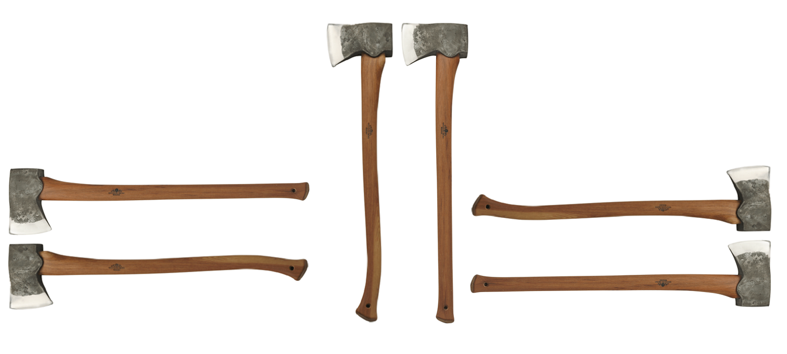

Another image to clarify my last post:
We see in this photo that given the same axe head position and distance the wrist could only be at the same distance in both situations by changing your body and wrist position on the curved handle to compensate for the ten degree change in angle/distance - essentially causing the axe head on the curved handle to be farther away from the target. Otherwise, leaving the wrist distance and body position the same would mean that the curved handled axe would be ten degrees forward (or whatever angle the Gransfors curve is set at) of the straight-handled head, approximately an axe head's length. This would mean sacrificing full swing potential, and the axe hits too soon.
Either way, an axe head distance must be compensated for when using a curved handle through the wrist position, body position, or the hang of the axe (which would sacrifice hitting squarely and/or pivot alignment).
You gotta break this down for me, I just can't get my head around it. All I can see is the head being closer. OK ETA: After reading it like 20 times. You're saying since the head is closer, the user makes a bigger swing to compensate for the head being closer?
I mean that it's either/or. Either the head will be closer to the target when your wrist is in the same location/distance/point starting the swing (since the angle forces it that way), or to make the head as far away as the straight-handled axe would be you would have to adjust your stance to compensate for the changed wrist angle, and thus make the swing longer.
There may be more whip with the curved handle, but due to the change in body position the axe would be essentially farther away since you are creating a new pivot with your body's position and movement, and the whipping motion would be less accurate by nature.
