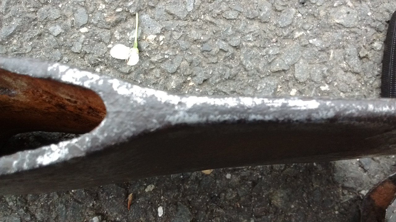

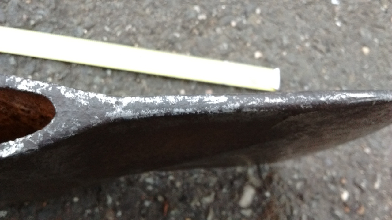

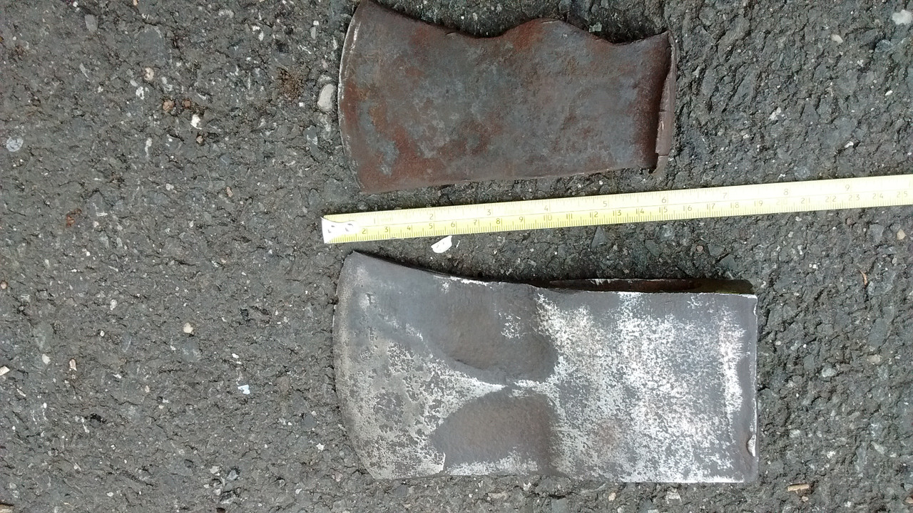

Let me dig out an axe I acquired few months ago from big auction site. Maybe I can get you decent pics of the welds. I just removed remnants of the handle: what a pain in the butt. When I was finally done I realized the top of the eye was actually 1/16 smaller the the bottom.
By the way, I blame this thread for most of my purchases from fleabay (I just cannot get the stuff I am looking for @ flea market, estate, or garage sales)
NICE,crbnSteeladdict,very interesting weld scene for sure...Neat as a pin...i want to say that the parts were swaged out in at least an open die...Geometry is nearly perfect.
Thank you,and sorry to lead you unto temptation...!:)
(that smaller head is very neat and interesting too,i really like it's lines in that top-view)

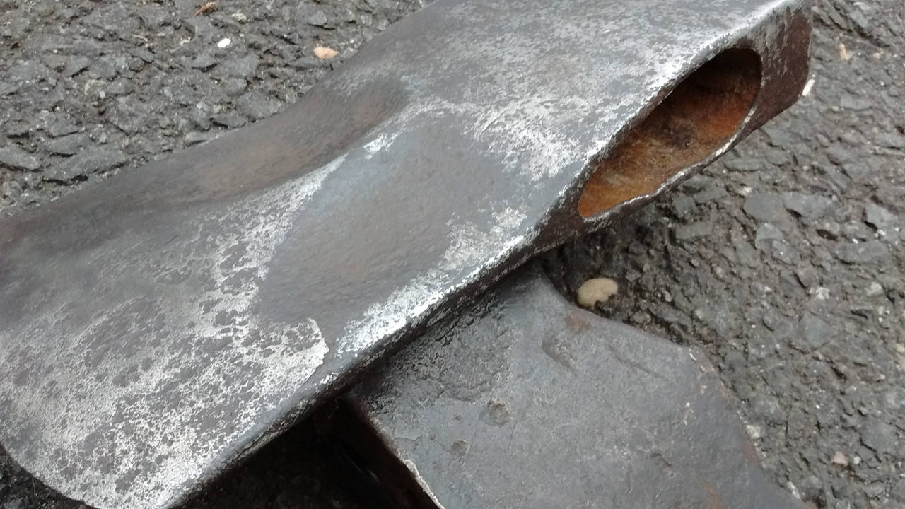

I suspect it is Falls City or Columbian version of Kentucky made Kelly Perfect (hard to find ones without any fancy etchings)
1lb 7.7oz. It is very hard to find Jersey pattern in that size(handmade is a bonus), so I am more than happy to deal with mushroomed poll. I have so many hatchets and axes ready to use but I will definitely make a handle for this one.

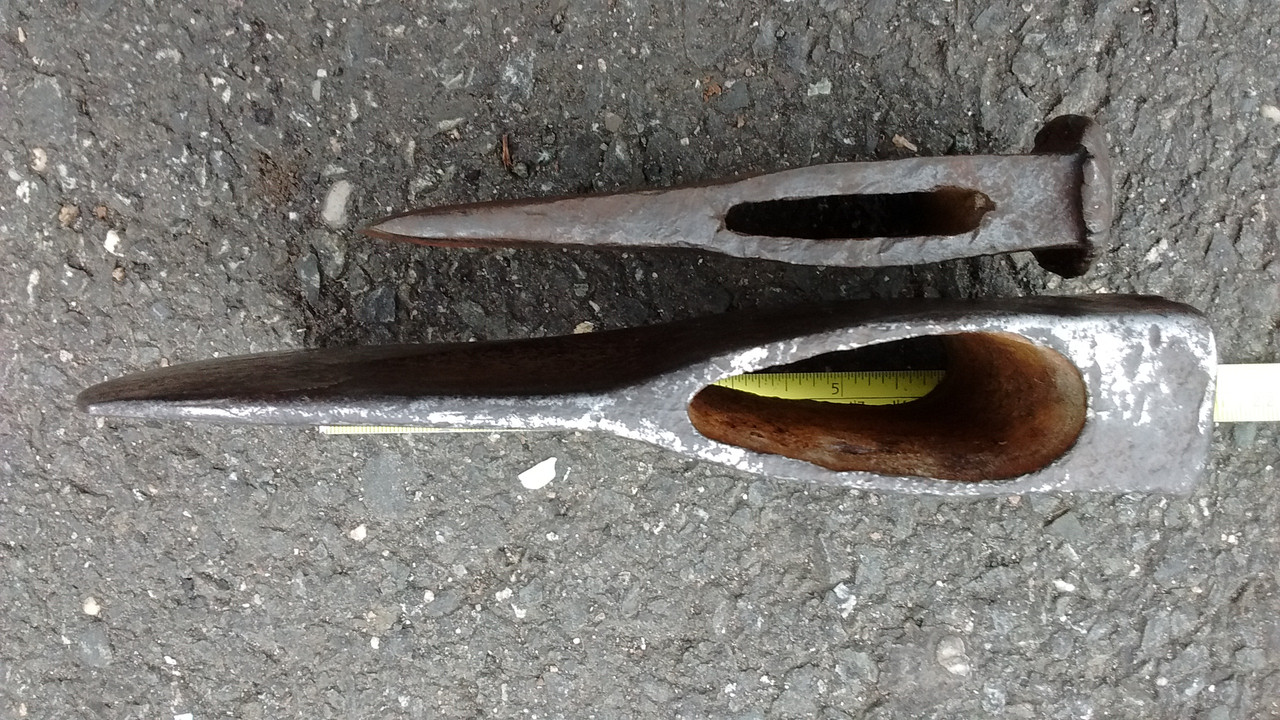

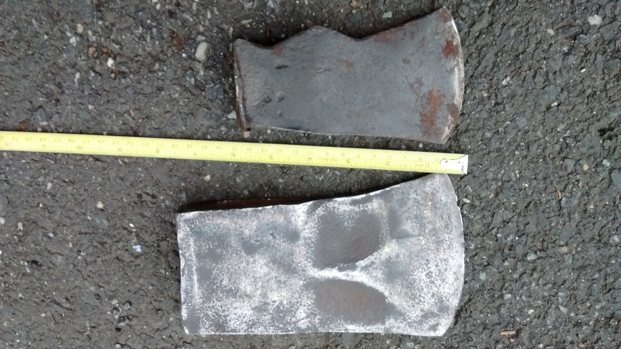

Thank you,this is Most interesting...Well,this is exactly what i'm wondering about...This VERY eye...
If possible,may i beg for measurements of the eye?...And do you think it was meant to have an hour-glass shape inside,or just be jammed on to be held by...magik?

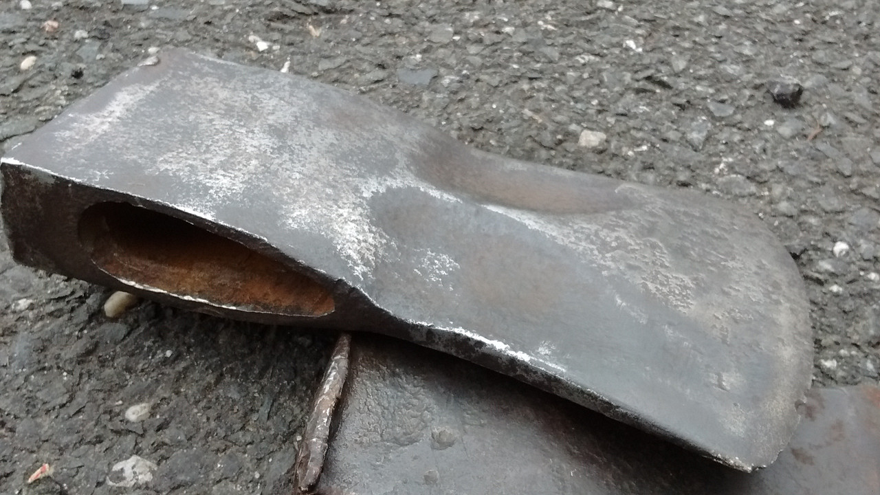

Sorry for the confusion. I was only removing remnants of the haft from WC Kelly axe (I was expecting top on the eye to be longer then bottom).
Jersey was sent to me as it is.
Weight 1lb 7.7oz.
Length 5 5/8 inches
Bit 3 3/8 inches
Poll 2 1/4 inches
Bottom eye 1 7/8 inches long and 9/16 wide
Top eye 1 3/4 inches long and 9/32 wide
Width measured across the top of the eye 3/4 in
Width measured across the bottom of the eye 3/4 in
The shape of the eye follows Pennsylvania Blacksmiths' pattern: wider on the bottom, narrow on the top. The walls around the lugs a very thin and much thicker at the top (3/16). I am pretty sure it is supposed to be jammed (I won't cut the haft flush, though: thinking about Plumb's take up kind of wedge on the top)
