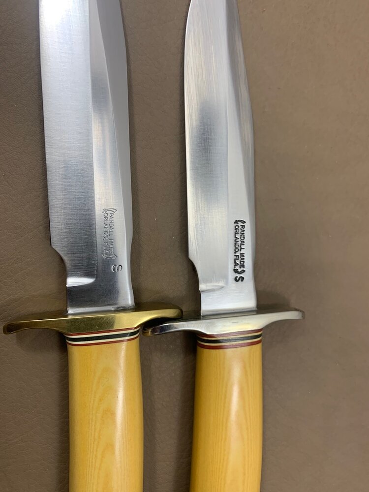

Here is a picture of two knives. The one on the left has an etched logo. The right is stamped. Oddly, this etched knife has a separate stamped S.
They have not etched logos in years. They used to etch when they had a light strike and the logo was ground out during finishing. They have a better striking process now.
The O on etched blades is round; the 0 on stamped blades is oval.
