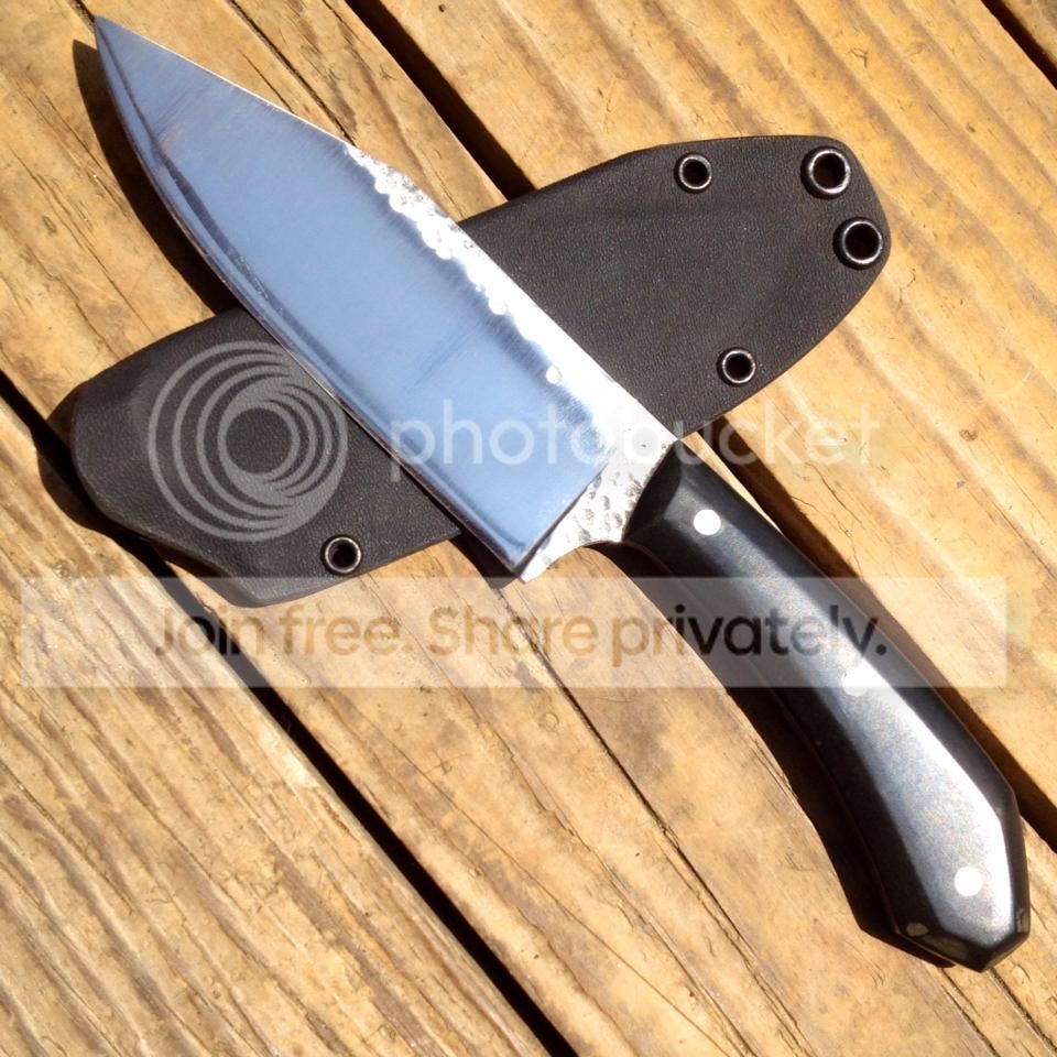

Bacon, not sure if you've seen these before, all EDC type bowies.

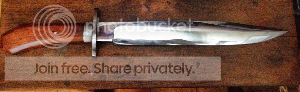

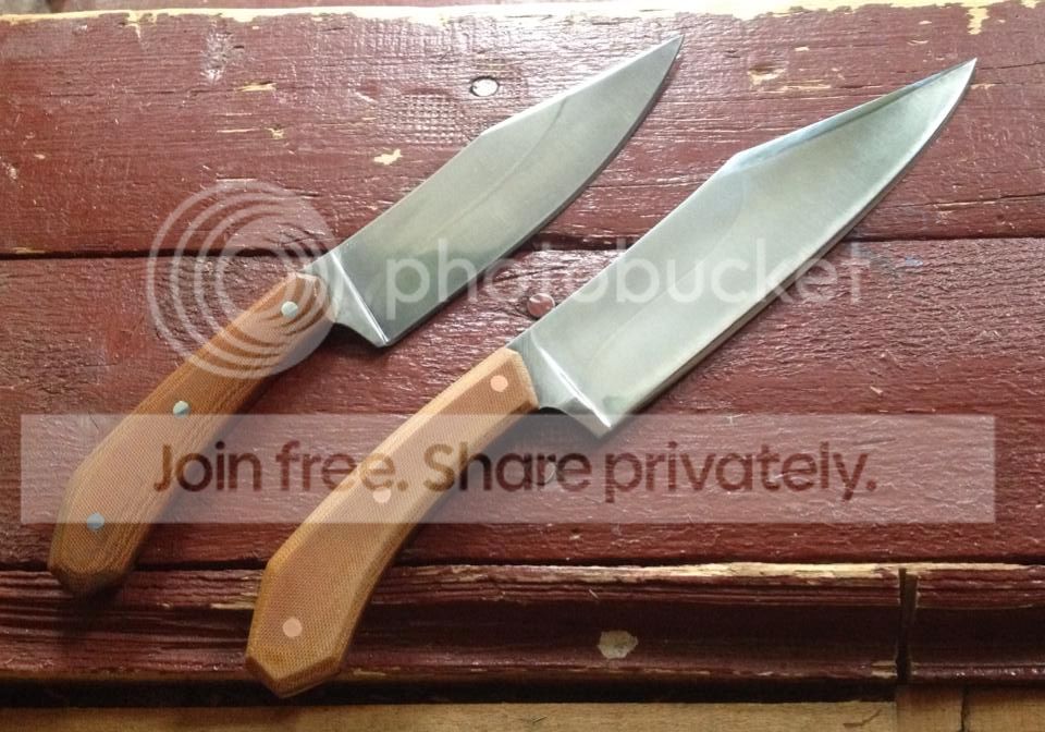

And yesterday I commissioned the build of 2 of the following, the knifemaker will have them ready for shipping by the first week of March. It's a newey of mine, and I've made numerous versions of it.
With relatively thick G10 scales, this profile's COMass will be well inside the scale area. And I've also commissioned the build of the deeper bladed version of this with another knifemaker, but the profile is not exactly the same as this, similar but with a different grindline and a V crown. That one will be ready in another 2 months at most.

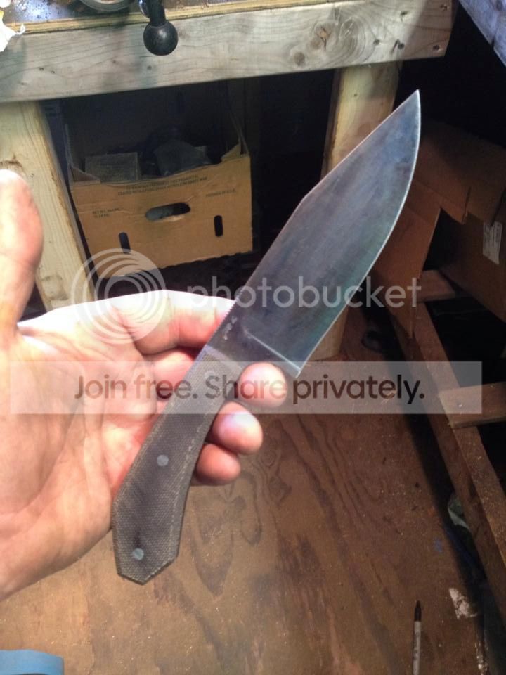

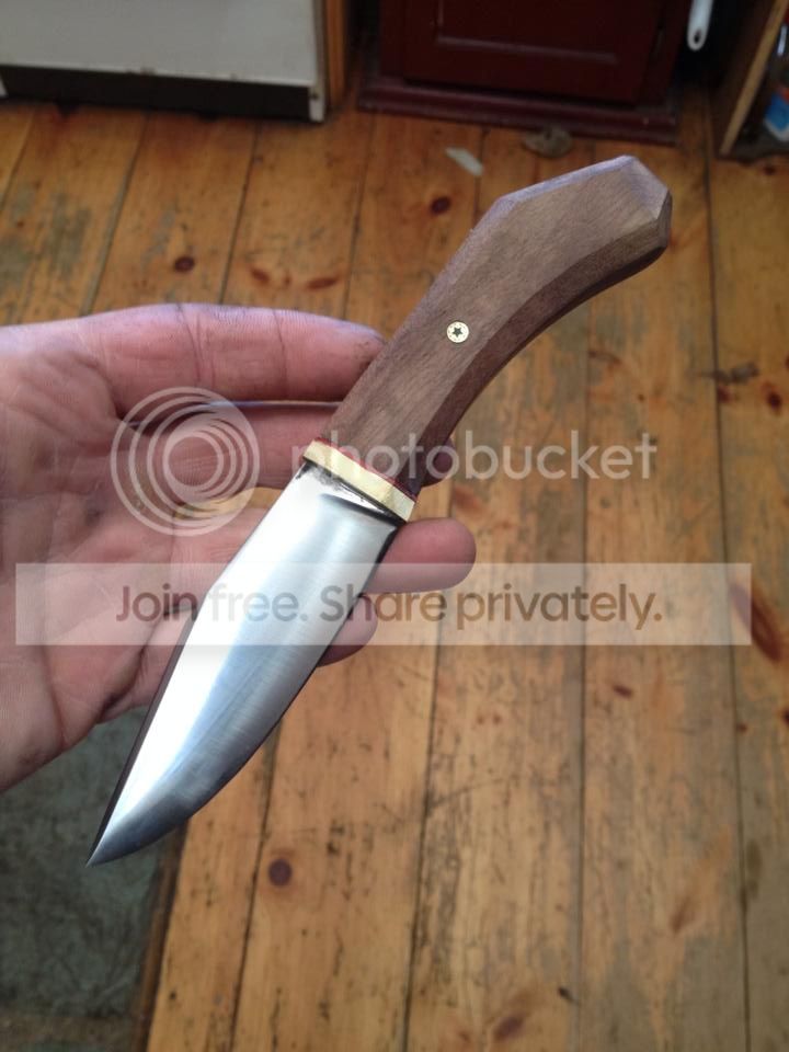

You know, what's funny is that when I was almost finished on your knife, I kid you not, I had a look at it and thought to myself that it looks a lot like HALF a dagger. I can see why Steven65 asked what he did. I've done what Steven asked, it's ready to post, but I want be sure you're ok with posting it. Let me know.
I was aiming for a very slender, dagger-esk type Bowie because A) We can't have daggers and B) Bowie's are awesome so why not make a dagger x Bowie :thumbup:
You're welcome to post/help out Steven65 however you like, using my design or not, I don't mind but just trying to keep this thread clutter free. Every time someone posts it seems 5 more people read the title and share their suggestions without following the whole thread lol

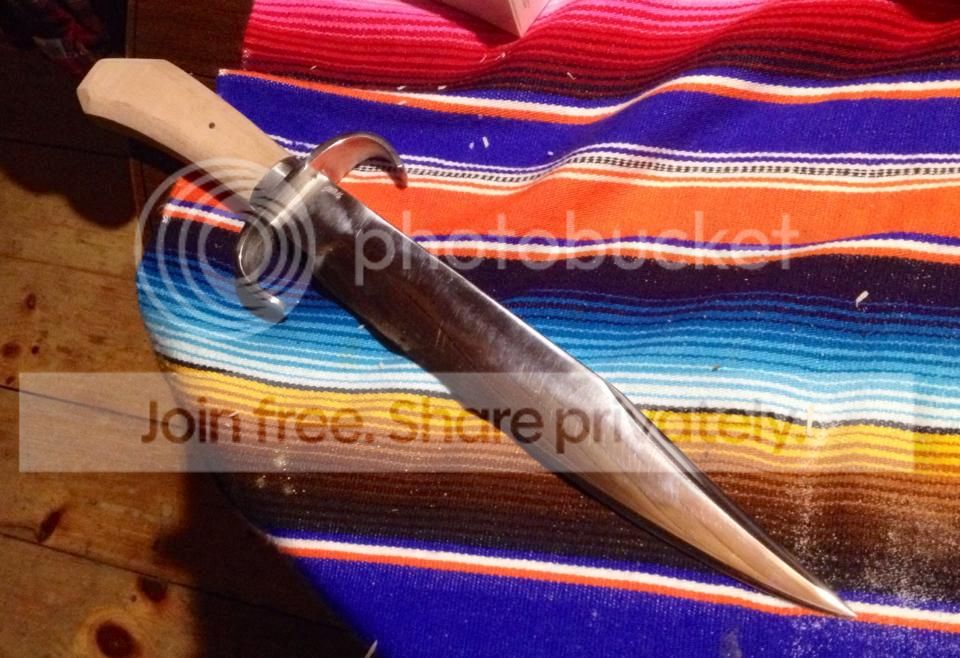

Here is the design and results of Bruce Evans' hard work on a knife we did back in '01
And a better shot of the knife itself.

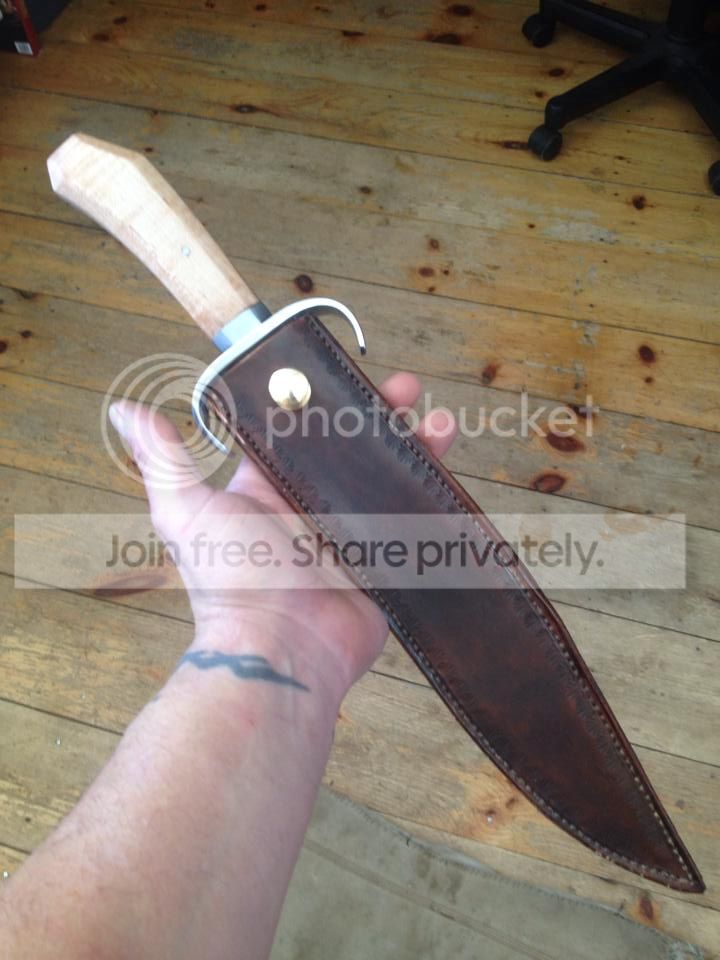

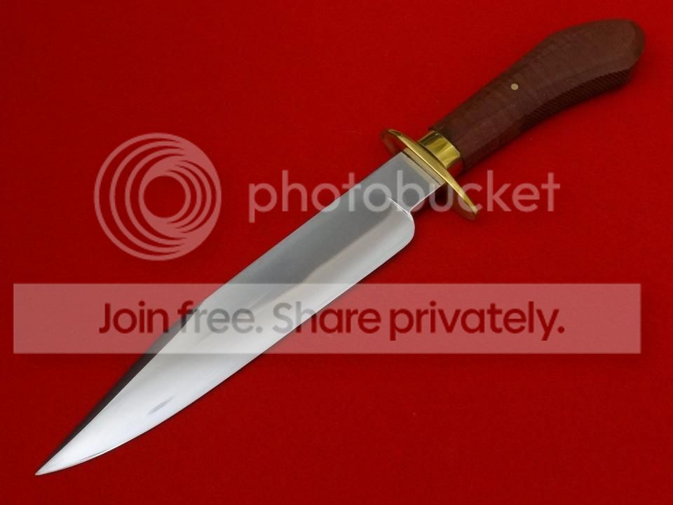

Where can I get a Bowie for a reasonable price that comes with a sheath that uses the stud as in the bowie pictured above. Preferably with a sharpened swedge.
Ebbtide, thanks for the kind words. Your Bowie is pretty slick too :thumbup:
Only issue I have is which I want to get made first...the 7" blade or 12" blade...decisions, decisions!
I don't know how this happened, but 2 knives somehow ended up in the following drawing and I just couldn't delete them... I think I might have to reboot my system before I continue with my graphics package. :D
lmao :D The dagger is pretty sweet. Maybe one day.... Also love your "Spartan Bowie". It's wicked.
Coke, I'm very happy with the design and don't really want to change anything.
I am interested in trying the knife with a 7.5" blade and a 8" blade. Just stretch it out a little bit whilst retaining the 1.5" blade width. If you could please make those 2 templates so I can choose the winner, I think that will be the final product.
FYI, I measured my hand width on the ruler and it was 3 3/4". Seems a 7.5" blade is the max but I would still like to see an 8" version if you don't mind making the template.
Thanks for your help mate!
FWIW, I made the sheath.
We have an excellent sub-forum for "Sheaths & Such" :D

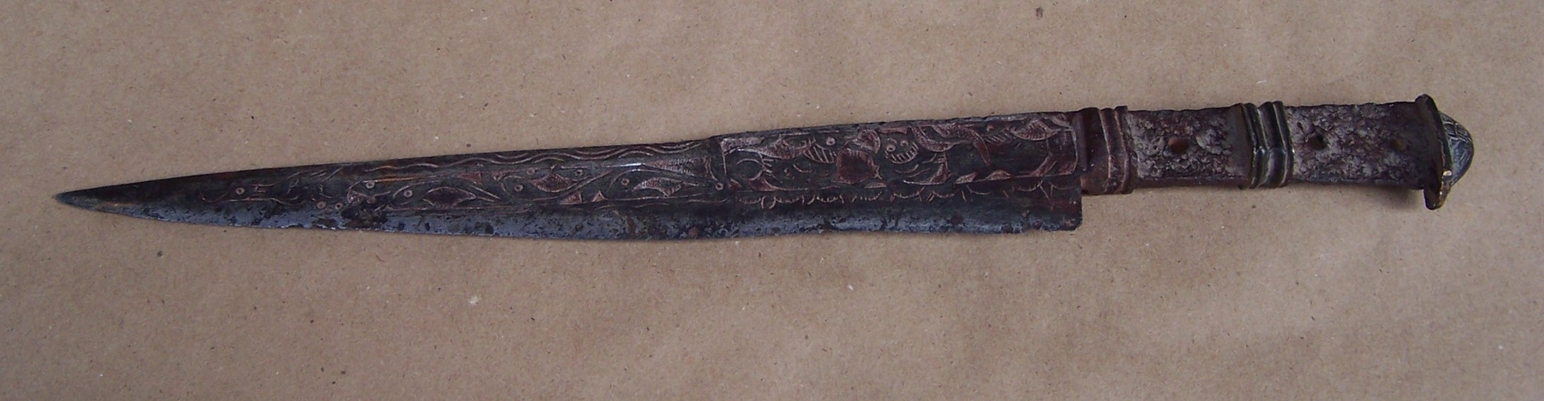

My grail "Bowie" is an early Spanish belduque.
65366d1279139425-where-can-i-find-sa-knife-
