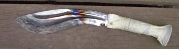

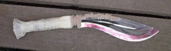

Here are two pix of process with YCS. My wife isn?t home today, so I couldn?t get a shot of the torch work or water pouring on edge, but these show a little of what?s involved.
First pic shows khuk with handle taped, red marker showing about where I?ll apply heat with torch, and heat trap paste to help protect handle, laha under bolsters, and especially brass inlay.
Other pic shows results ? color zones indicate areas of greater and lesser hardening (sorry the true colors just don?t reproduce well, but at least it shows that there are differences.) Most of the heat paste falls off during heating, but it works well enough that all brass inlay survived fine. A thin line ? less than 1 mm ? of laha seeped under one bolster but that was all. When I removed the tape I found that the handle and inlays were totally unaffected.
Chopping tests came out fine ? the piece of juniper that turned the wire edge before now has no effect on the blade from point down around belly. I chopped into the base of a small branch on the juniper and it had no effect on the blade at all.
As you know, this blade has one of the thin edges Bura refers to in his mail you posted on the forum. I?ve kept the edge thin but let it draw back a little softer than you might like for yourself ? I?d guess it to be Rc 59 or 60 around the belly, maybe 57 to 58 at point and behind belly. I could make sure that any others I do stay harder, especially those with convex edges.
Khuk still has colors on blade, but has had blade washed carefully (heat paste can leave marks if left on too long) and oiled; the handle has had a little tung oil applied in case it dried during heating.

And here's the before pix.

And here's after some expert heat treatment. I know it looks ugly here but I'll bet another $10,000 that when Art is finished it'll look just like the day it arrived here.

There's no doubt that Art knows what he is doing. Art, do you have a couple of pix of knives you have made?
Art, that is AWESOME!!! How long does this prosess take and do you qwench with water when the blade is red hot? How long do you run water over the hot edge? Great work!!!!
Thanks,all.
The heating and water quenching by themselves don't take long, maybe 20 minutes for each at the outside. Prep work, setup and cleaning the blade take longer and could bring the total time up to several hours. I'm doing the hardening pretty much like the kamis would. Heat the blade to red hot (I do just the edge to protect the handle and inlays if any but the kamis heat more of the blade) and cool the edge rapidly with water from a teapot, then use water to cool the rest of the blade a little slower. It's been a lot of fun learning how to harden the blade without my furnace, oil quenches, etc.
