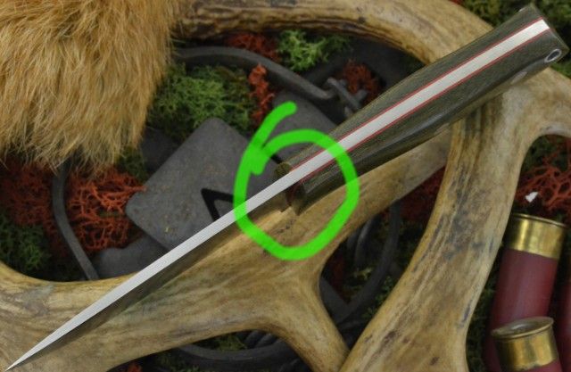

A lot of custom and production fixed blades follow a common trend for handle scale design. The front of the handle (the handle portion that terminates close to the blade) has a sharp 90 degree angle ending, without any radiusing or contouring.
I'm curious if there is a reason for this? Does it have a utility purpose? Is it very difficult for knife makers to smooth or curve this area? In use, I've found it can be slightly uncomfortable in some grips.
Below is a photo showing the hard angle at the front of a handle scale.
I suspect it simplifies manufacturing.

Your example picture has the same at the other end, which irritates me more. Easily fixed.

Sharp angles at the rear of the handle can indeed be very irritating if it jabs your side in a high hip carry sheath. I have one such knife myself with stabilized maple burl scales.
Do you think I could sand this down myself, or would I not be able to replicate the knife maker finish?
You could probably reproduce it. Yours looks like a glossy micarta. Before you start, search the maintenance forum, or start your own how to thread. You need to make sure you have the right tools for the job, or be prepared to refinish the whole handle to a slightly different level so it all blends in. I personally have worked more with wood than micarta.

Randalls have brass guards because they have hidden stick tangs. It takes a lot of screwing around to have a full tang AND a wrap around guard because you have to create the guard in place.
Hidden tang knives have guards or other caps at the blade end to hide the big ugly hole running into the handle. You only need to precisely fit the front end of the guard to the blade.
On full tang knives (which everyone currently thinks are stronger) a metal front guard means that you have to drill more weakening holes in the blade to pin the two halves, or braze it around the blade - which isn't so hot for heat treatment.
In terms of the OP, when you're permanently mounting slabs on a blade, you pre-finish the sides of the blade and the front ends of the slabs because grinding that inside corner later risks screwing up both. Then you pin and epoxy the slabs on and grind them flush to the exposed tang, rounding that grind into the side. Doing this the "safe" way means avoiding getting the grinder anywhere near the side of the blade, which is why knives of that construction tend to be squarish at the front of the slabs where the pre-finished part of the scale meets the post mounting finishing.
It really isn't about lazyness - it is a smart practice that in no way negatively impacts function.
ESEE's and Beckers have bolt on scales, so they can be completely finished away from the blade, which makes it safe to round the front end.
All of these methods involve shortcuts, so talking about one as cost cutting is ridiculous. Only something like a CRK Project 1 avoids shortcuts by creating the blade, guard and handle out of one continuous piece of metal. Most everything else is a way to produce a knife with the least amount of unnecessary work.

It's only difficult to shape if you do it after the handle slabs are affixed in place.
After the pin holes are drilled and before the scales are epoxied into place is the time to shape the front of the handle.
Put the scales together and align them with the pins in place.
Shape away. When shaped and polished they can be affixed to the tang. No more work on them is necessary.
As to the square edges... it is way easier to square up and polish a square handle like that than it is to evenly contour the handle front and have it match side to side. Squared end is just a matter of pushing the blocks against the platen. Done & off to polish.

And you can curve everything as Ebbtide points out. But part of the reason for the corner is because of the aesthetics of having a sharp line where the scale meets the spine. If you round the outer edge you have to round the edge where it meets the spine. A square spine edge and rounded side looks bad - so you choose one or the other.

Whether or not you think it's a big deal is entirely up to you. Some folks don't care at all. I try to avoid sharp corners like that based on the majority of my customers' feedback. I've never had anyone specifically ask for edgy, blocky handles... ;)
Not really. It's not that difficult to shape a bit of radius on the front of the scale after it's mounted to the blade, and achieve both a comfortable front and crisp "joint" where it meets the spine. You just have to exercise a bit of care to avoid scratching up the blade.
