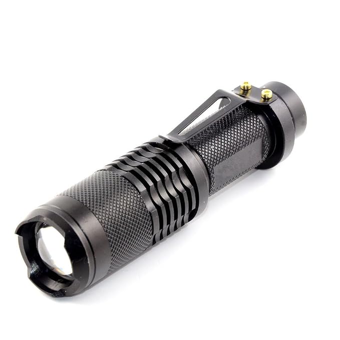

The flashlight shook up the flashlight world is the SK98. It takes a 18650 Li-Ion battery and is brighter than flashlights costing ten times as much. Street price is around 10 bucks. It's not a brand name, but rather a type of flashlight that has a Cree XML-T6 LED, and dozens of factories in China churn these things out, so QC is not always great. I buy the Ultrafire brand, but even then they don't always come from the same factory.
The miniature twin brother of the SK98 is the SK68, which can either take either a AA or a 14500 Li-Ion. SK68s run about 3 bucks apiece. I buy them by the dozen and always have one in my pocket. (they are a little more pocket friendly than the SK98)
Both of them look like this:
That's pretty amazing at 2500 lumens on high. I wonder if it might catch on fire.
Properly constructed, an SK98 will distribute heat evenly and the cooling fins will keep it from getting too hot. (don't believe the inflated 2500 lumens) If you leave one on in your pocket, it'll get pretty hot, but then the SK98 isn't really a pocket flashlight like the SK68. There are some bad ones out there, however (stay away from the SiPiK). I carry a SK68 in my pocket, and they will get a bit warm if you leave them on in your pocket but not hot.
