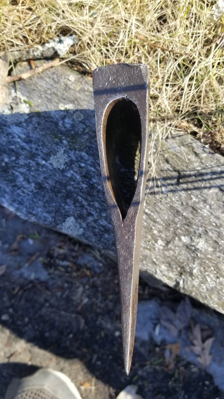

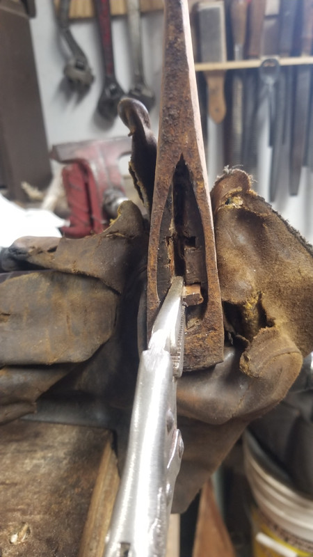

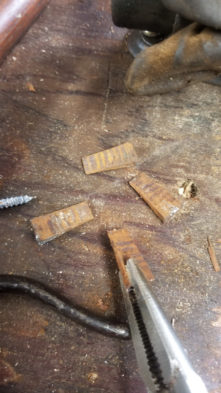

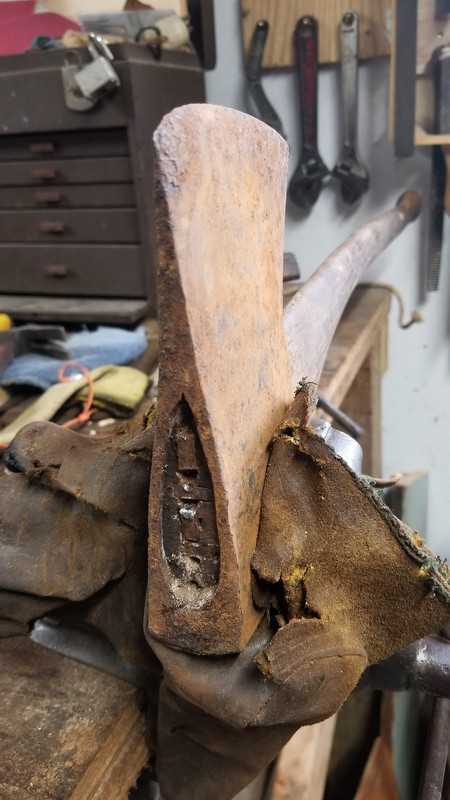

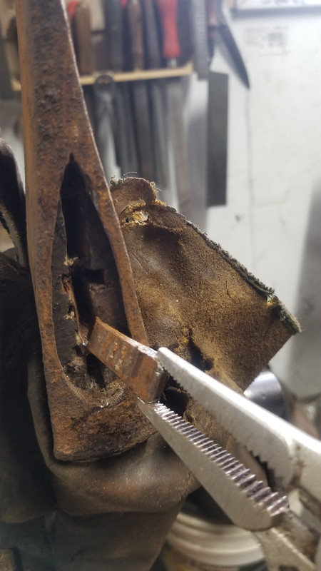

So this is been working out really well for me and I wanted to share. I mentioned the idea some time ago and one of the various threads with hundreds of replies, but I can't remember where. I had been drilling and tapping in metal wedges and drawing them out by turning the screws.
Well tonight I was thinking about the fact that these wedges are always soft steel. So I wanted to see if I could do it quick and dirty with drywall screws. Turns out it's not even dirty, it's just dead easy.
In short the process is this:
-Pilot 7/64" hole in metal wedge.
-Pilot 1/8" hole in hard wood scrap
-1.25" drywall screw goes through the 1/8" hardwood and drive it into the 7/64" pilot in the metal wedge
- Find your good fulcrum point and tap the right spot with a mallet
Turns out it only takes 1 drywall screw. I knocked a bit off the point of the screw so it will start grabbing right away. Here's two examples:
20190129_212613-784x1613.jpg 20190129_211727-784x1613.jpg 20190129_212352-784x1613.jpg 20190129_212530-784x1613.jpg 20190129_212850-784x1613.jpg 20190129_213555-1613x784.jpg 20190129_213650-784x1613.jpg
Hope it's clear. It's only taking me 2 minutes to pull out metal wedges.
ETA: the way the photos are posting is not exactly linear, but hopefully it's enough to get the idea across. Works a treat.
I do the exact same thing for removing the wood wedges. It hadn't occurred to me to do that to remove a step wedge though. I just tap them back n forth with a flat head screwdriver and they back out after a little effort. It's a great suggestion though and there's a couple times i can think of where i wish I'd thought of doing that.

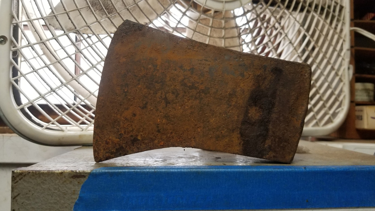

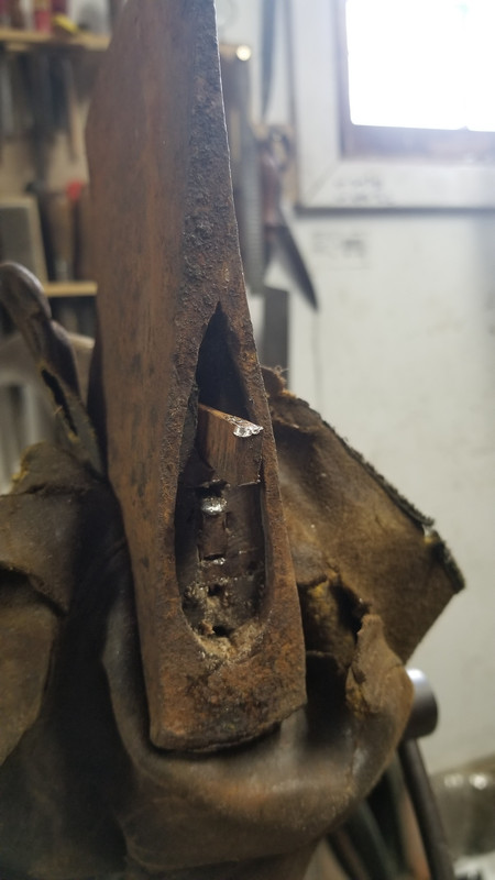

Not sure about easy...but this one went smoothly. Though always unpredictable, this one looked like it would be straight forward.
After all it only had FOUR metal step wedges. No nails, screws, screwdriver tips...
29" handle
3lb. Head
Very rubbed out stamping.
Now...
Connie or Dayton? :cool:
My first impression was Dayton...more I handle it, could be a worn connie.
:rolleyes: Are they not ALL just worn connies?:)

I like what you did with the screw. That would push those steel wedges apart to wiggle them out? Or maybe grab the screw with a hammer and leverage one almost out?

The slightly oversized wood screw does a little of both...and when the wood wedge gods are watching minimal damage occurs like this one.
Boy once they start throwing screws in that have been hammered on...all bets are off trying to maintain any integrity to the top 1/4" of the tongue:(

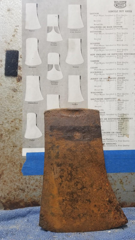

No luck on stamp recognition yet, guesses and hunches only.
I have been bouncing between Kelly and Rogers but not wanting to limit with so many possibles.
I still have to get to cleaning and I hope there is a weight stamp under the pole at the shoulder just to provide another lead and add to the confusion.

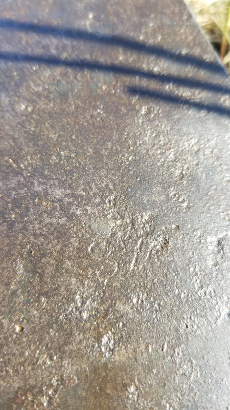

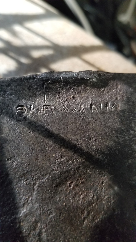

I was able to clean away quite a bit of the head and have now more questions and no answers.o_O
My scale has the head at 3lbs. :thumbsup:

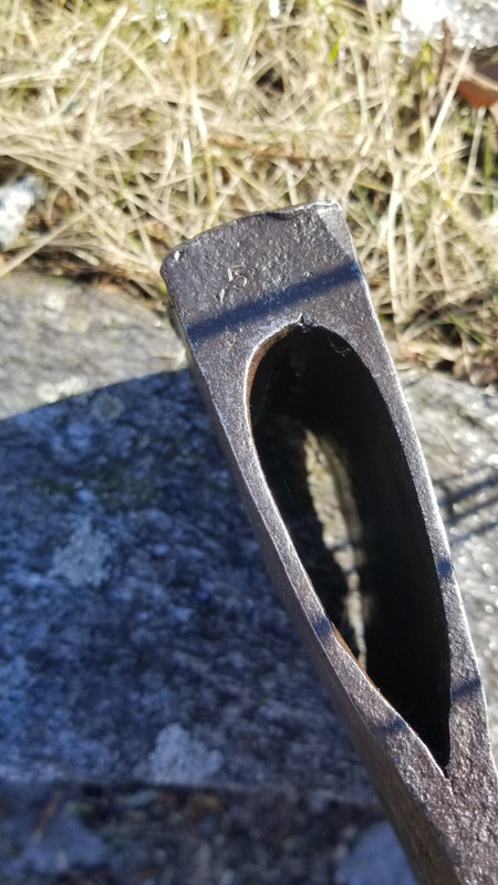

I reveal a 3 1/4lb stamp center of the axe on the cheek...promising, a close weight.:thumbsup:
I then reveal a 5 under the pole at the shoulder, hmmmm.:eek:

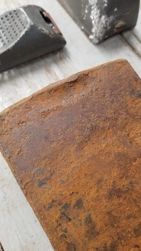

And of course the wholly and incredibly illegible name stamping. :(
I have not given up, however this one is tough :cool:

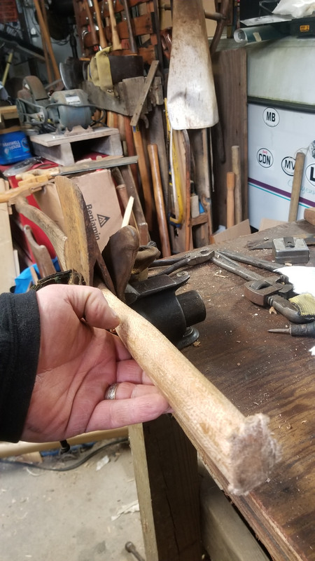

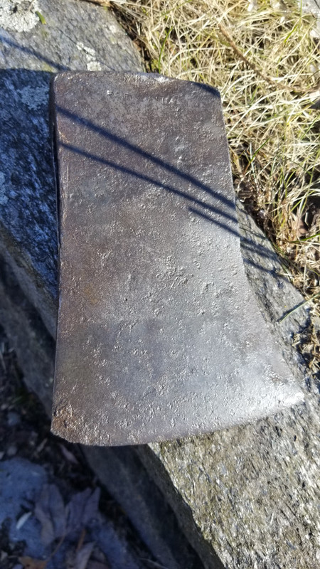

Loosely slipped back on the 29.5" handle it came to me on. Legitimus underneath for similar handle comparison, 28"
Does anyone else read, Transylvania 6-5000?:cool:
Old yank ???? Doesn't help that it's double stamped. That cleaned up really nice!
That's better than my guess by far.
I was wondering...dbl stamped or is it the font, almost block letter? That would be crazy though.
It cleaned up fairly well thanks, a little more detail work but it's a great looking axe and has a good feel and weight.
