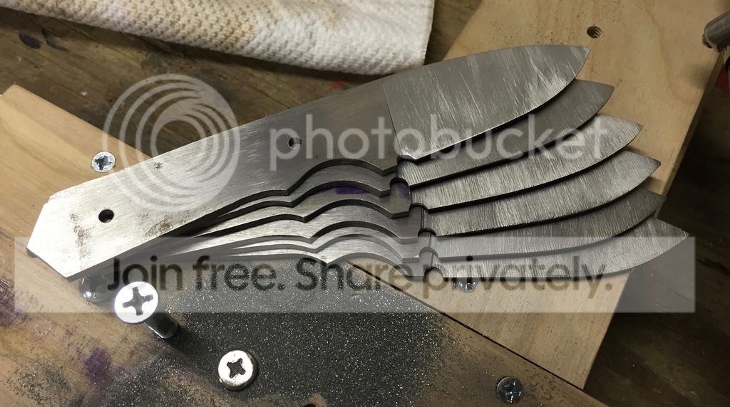

What, you didn't think I gave up on this did ya? Just got busy w/ holiday stuff like everyone else. These will still be gifts, just not Christmas gifts....for 2015 atleast. Just finished grinding the last blade last night. All 6 are ready for heat treat! Gonna go old school, backyard fire pit w/ a hair drier and pipe. Fingers crossed!
Looking good! if you are heat treating several knives at a time i would say it is best to heat one up, quench it, then it straight into the oven. Trust me, a fresh uenched blade is a LOT more brittle than you think it is, or want it to be.

PLEASE please please take the dust bag off your belt grinder. Huge fire hazard.
The knives looks good. It isn't so easy making repeats like that. Have you tried "draw filing" them with a single cut file yet? From the look of the stroke marks you may find it fits somewhere in the next few steps.

We had one casualty, the 1st one. Didn't realize how quick the blades can get hot, and cooked the tip right off! Anywho, outside of that, everything went according g to plan. Heated to non-metallic, put it back in the fire for 10sec, and quenched in canola oil.
Setup: Hair Dryer, 3' of 3/4" iron plumbing pipe (not galvanized) piece of wood for the blades, a new paint can full of canola oil, welding gloves and some vice grips.
After cleaning the blades with dish soap, it's into the oven at 450'f for 1hr. X2.

Any tips for grinding/sanding after Tempering? What grits to start out with etc..?

On your post heat treat, I usually back up one grit from where the blade were before they went into the fire. If I had them at 220 prior to HT, I start at 180 post heat treat.
