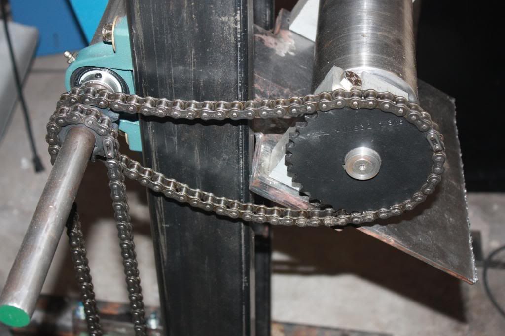

This is a rolling mill of my own design but with ideas borrowed from others I have seen.
First off I am 6'3" tall so the working heigth is about 45 inches. This lets me take a built out of the forge and straight to the mill with out having to bend over.
For safety it will feed out towards the user like the McDonald mill and will have the peddle to raise and lower the lower roller, but probably not the levier adjustment.
There will be a screw jack to adjust the lower roller as well.
Both rollers will be powered.
The rollers are 4" in diameter and 8" wide solid chrome molly steel.

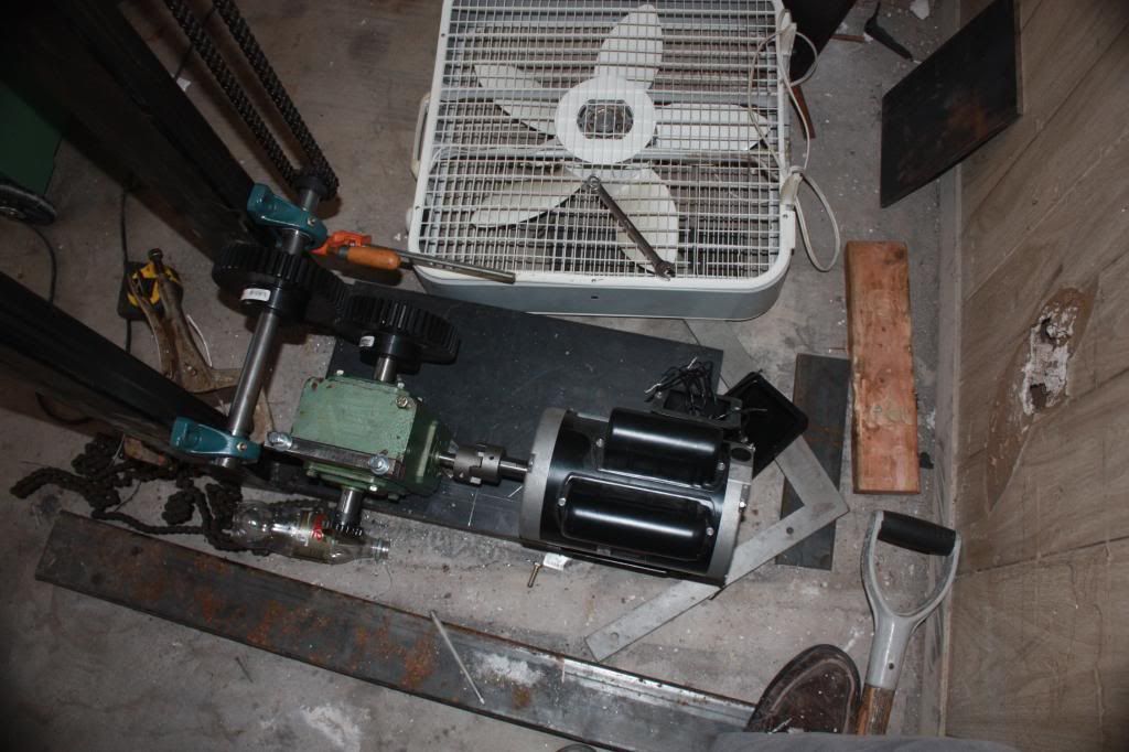

It is powered by a 2 HP 1725 RPM motor into a 60:1 gear reducer and then further reduced by 2.5:1 which will give me between 11 and 12 feet per minute speed at the rollers.

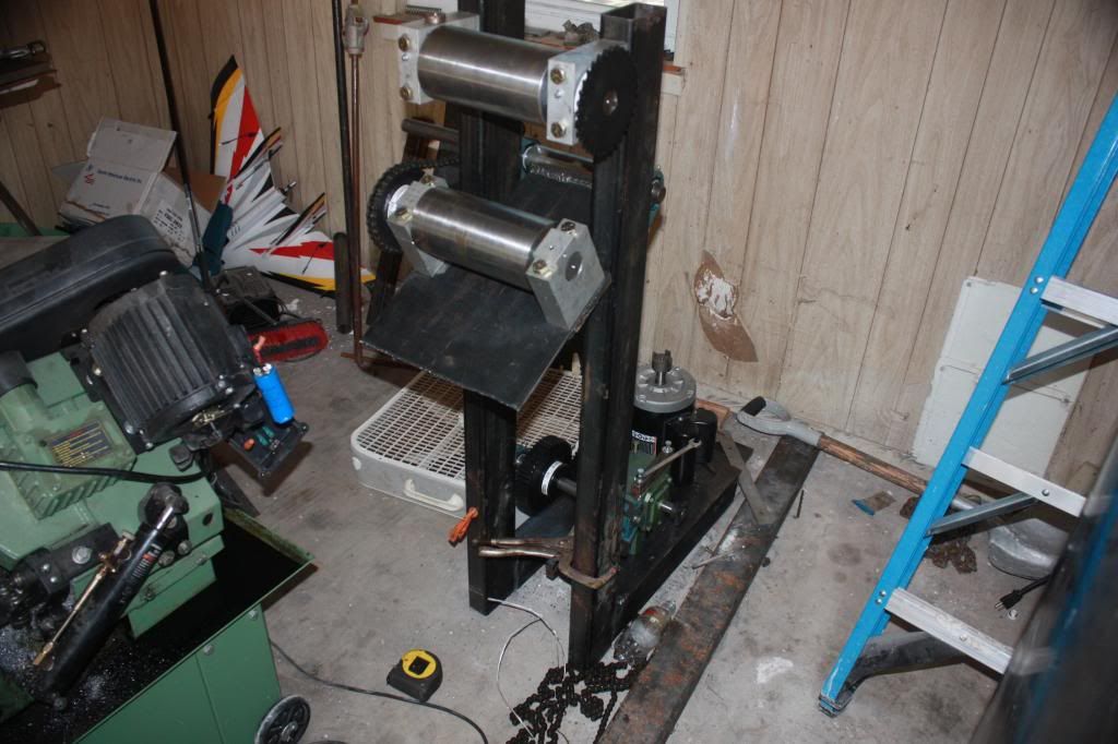

Ok Guys I didn't get much more done on it last week. Because I had sold a grinder and had to get it going, and getting ready for the
"introduction to Knife making" get together we had here this last week end.
But I promise to make some headway in the next two weeks. Johnny Stout wants me to bring it down to his place on the 26th to show off at a little get together he his having. And I am going to do everything I can to make it.

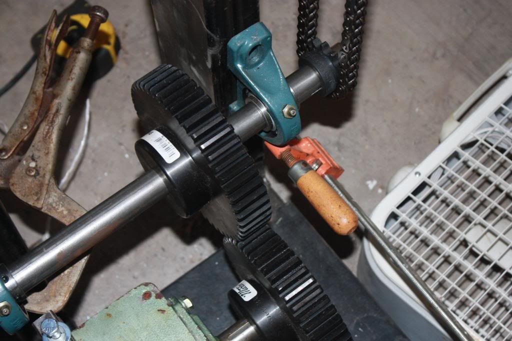

I had to build some riser blocks to raise the gear reduction unit up 1-1/2" so it would mate with the motor. Keyways have to be cut in the roller shafts and the lower shaft holding the gear. The gears have to be broached for a keyway and drilled for set screws. I will have to have the broaches cut at machine shop because I don't have a 1/4" broach.

But all is well, i had to cut some welds open and reweld them do to things not lining up.
I have the peddle assembly figured out and much of it welded up. Next will be to build the top bracket where the acme thread attaches to the bottom of the lower roller assembly.
Then I will strip it all apart for painting.

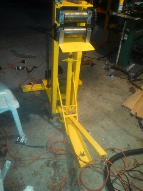

Johnny Stout had a group of knife makers gather at his shop Saturday about 10 to15 were there and we put the RM through the paces. It has plenty of power and as I had hoped the steel did not curl up when comming out of the rollers. It did have a problem curling the metal sidewaysdue to the metal plate the lower roller mounts to will twist when the steel is not in the center of the roller. This should be a simple fix..
we took a 1/4" x by 8" bar and rolled it out to1/8" X 16-1/2". More later.
Getting back to the rolling mill. Its been a busy couple of months . But I am taking time to finish up the mill. This week I have made the needed refinements. I have strengthened the lower plate that the lower roller sits on so it won't twist when steel is not in center of rollers. I have beefed up the peddle so it won't bend. I have added a second diagnell support bar . I am adding two pillow blocks for the peddle assembly. Still need to add the peddle stop to keep the peddle from coming up to high. And springs to raids the peddle . I have started painting the pieces.

Will the mill is all back together. I haven't ran any hot steel through it yet but it appears to be working fine. On the first trial run the plate that the lower rollers set on wasn't strong enough and would twist causing a miss alignment of the rollers.
I welded a reinforcing plate and some webbing. This problem appears to have been fixed.
