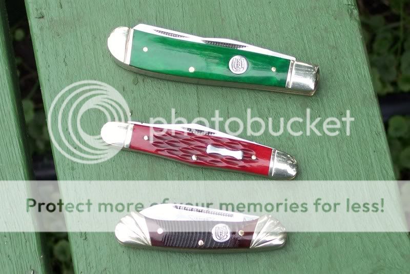

Hi,
I've had these about a week now.
I've never had these patterns, so it's been fun trying them. The fit and finish is a little variable between the three. The green mini-trapper is far and away the best for fit and finish. I'd put it against any production slippie out there. It walks and talks. And I've come to find that I kind of like the pattern. It's as good a working knife for my day to day use as is my stockman or Vickie Soldier.
The half-whittler is a real surprise to me. It's not quite as good a fit and finish as the trapper, but still pretty darn good. The blades don't quite have the nice snap on opening or closing. And the dye job was not well matched on the jigged bone scales. But I really like carrying it. It's light and easy in the pocket. Didn't think I'd really care for it. I only got it because SMKW didn't have the mini-sunfish I wanted.
The mini-canoe is perhaps the disappointment to me. While I adore the saw cut bone and fluted bolsters. The fit and finish isn't as good as the other two. There is a .004" gap in the back springs on one end. And the a small .0015" between the brass liner and one bolster. (Hey, as a machinist, I measure:)). I know it's not going to prevent it from being a good user. It's just I was hoping that it would be as good the trapper. It's a good slicer though. With a .045 thick main spear point blade it sliced through a cardboard box, a foil pouch, and 2" thick styrofoam with ease. I will continue to carry it, though perhaps not as often as others.
All in all, I like my new knives. Rough Rider provides me with inexpensive slippies to expand my horizons all the while making a good solid knife. Could you imagine if RR offered plain carbon steel at these prices?

Hi,
Yeah, the colors are pretty bright, but I was going for different. :D Actually, the trapper is close to a mallard green. And there are few things I like better than the sight of a bright green-headed drake mallard sliding into my decoys on a frosty morning. So I kind of like the color. The red whittler, well red don't need no reason.:D:D
The only way to know how they will hold up is to get one and use it. My personal opinion is that they will last about as well as any production slippie. Most slip-joints don't get used hard. A few of us use our knives often, but care for them properly. They are pretty well made. And others here can testify to that. Their weak point is the 440A steel. And even that isn't too bad. I tested a stockman my Wife latched on to at 56Rc and a $4.50 liner lock at 57Rc. Perhaps if I remember I'll test that Trapper tomorrow.

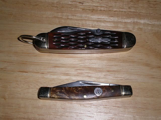

I have bought 8 RR in the last two weeks. All of them have had really good fit and finish. Here are two stockmans in orange smooth bone.

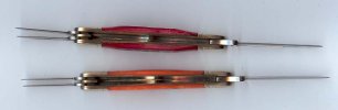

Moon,
That's a strange tapered spacer there in the back of that whittler. Can you post a pic of the 'top views'? Ie, looking down on the blades, both open and closed?
I gotta get into Rough Riders, right up my collecting alley...cheap quality. :)
Where's the best place (price + service) to get them?
Thanks,
JMH
Here you go:
You can't see the backspacers in the closed pics, so I didn't put them up.
The backspacers are nicely tapered. It looks a little funky in the first image I put up- it looks like there is a big gap- but you have to bear in mind that the knife is pretty small- not much bigger than a peanut. Oh, and that little spot you see in the gap is a grain of sand or something. I didn't notice it until I posted the pic.
