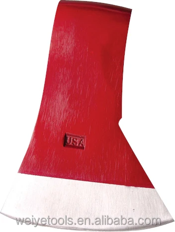

Back around 2012, Harry Epstein's online tool store was selling a "Russian Axe" as "military surplus" for $20.
So a bunch of these are in the US now:
The axe head weighs 2 1/2 lbs. Cutting blade is 6" long. "1982" is stamped in the head.
(from the Wayback Machine)
I recall that somebody on another forum (bushcraft?) commented that the stamp on these "Russian" axes (from Epstein's) had a couple Chinese characters. So I'm wondering how many "Russian" axes are actually made in China?
A quick look at alibaba shows the following axes as being available from Chinese manufacturers:
