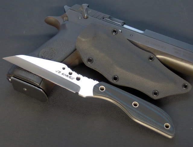

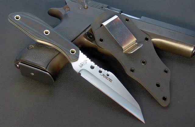

A new one on its way to a BladeForums member!
-3.75" blade; 8" overall
-1/8" thick A-2 tool steel
-H.T. and cryo- temper by Paul Bos @57-59rc
-Black and blue G-10 scales, grey spacers
-Right hand pocket carry sheath w/ drain hole
Thanks for looking!
im kinda upset i didnt see this one earlier. i probably would have jumped on it. although i dont know or have heard anything about A-2 steel. how does it fair in relation to other big name steels?
Thanks for the comment! This is a design I make and sell regularly, and I have a few others I may post on BladeForums in 4.5 and 5- inch blade lengths when they are finished. I personally use A-2 because it takes and holds an edge better than any other knife steel I have used yet; and that is what I consider first. As long as it is taken care of, it is not prone to rust in my experience either.
