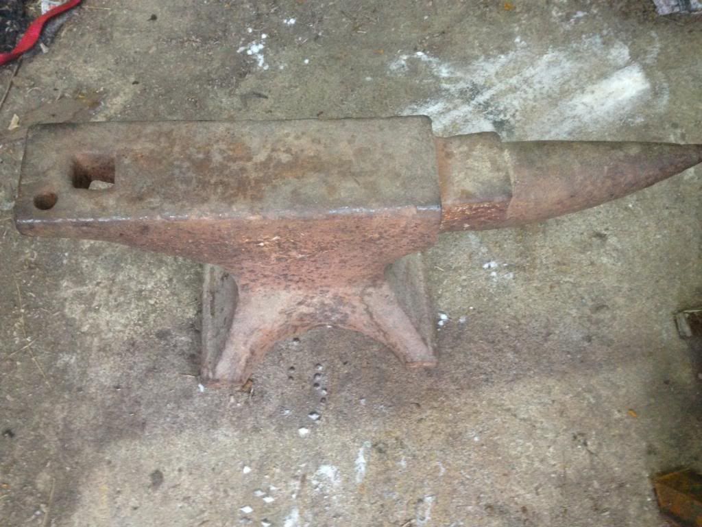

I got this old anvil off a guy, I was using a really heavy 3 inch wall thick I beam til now. This is about 150 pounds or so. Any suggestions on cleaning it up? the edges are a bit beat on it,. the tops pretty flat but not perfect. Should I grind everything smotth and square or leave it alone?
Can probably take it to a machine or engine shop. They can surface the top so that it is clean and flat. Don't take off any more than you need to to get it flat.
Looks like a PW or maybe Arm and Hammer to me, but not a Vulcan.
I wouldn't take it to a machine shop. Just use some flap wheels on an angle grinder to skim around and get things flatter. Try not to create low spots. A machine shop may take off too much and cost a lot, when if it's pretty flat under that rust you can clean it up yourself.
The flats on the feet say PW to me. Wire brush and use it. It will shine up nice and pretty with use. If by chance you can't be talked out of machining it, make sure to machine the bottom first to make it parallel with the face.

Thanks guys, I have a milling machine.. I could skim the top real light with it I suppose? Maybe I'll clean it up with out doing that though,. see how it works, and I'll use the mill as a last resort. I'll look to see if there's any letters or marks on it as to who the maker is.
I agree with the others-wire wheel and/or flap wheel on an angle grinder. Mine was in not quite as bad a condition as far as the amount of surface rust (ACME anvil made in 1907). It had chipped edges so I took the grinding wheel to it on the sides in an effort to get them more square. In hindsight, I kind of wish I'd just left them alone. You might be surprised how flat you can get something on an anvil with slight dips or variations...which seems counter-intuitive. If all you do is clean it up a bit and after some use you find it really needs more work, you've lost little. If you go straight to removing material, you can never get that back.

Never mill an anvil. First, as this one is forged, the feet and face aren't guaranteed to be parallel. You could take off too much and ruin the anvil. As said, start with cleaning it with a wire wheel. Forging alone will clean up the anvil pretty well.

If you're looking for the face/base parallel, mill the bottom of the anvil... Never the face...
I got money on it being a Boker Trenton or a PW... Weather it's marked in pounds or stone weight will be the tell... :D
Thanks for the comments, I still havnt got to use it I've been hard at it trying to rearrange my shop. What will milling the anvil actually do to harm it? I'm not going to,. I'm just more curious now as to why not to
Reasons why... That's a wrought iron mass with a tool steel top plate forge welded on top. The plates thickness varies in thickness depending on it's overall size, but usually never exceeds 1"... Fishers are an exception because they adhered a double-thick tool steel plate in their castings... Any steel you remove from the face of that anvil, it's gone, and you wont get it back unless you weld on it...

If you mill anvil it can lose its hardness due to the nature of the material underneath the top plate being softer... While the tool steel might still keep it's temper, it will deform...Wrought is very soft in comparison to tool steel. That's why over time, heavily worked areas of the anvil will dip... Sometimes this is called "broken back" or "sway-back"... This even happens with anvils that keep much of their top plate, the soft wrought just deforms over time...
A few hours of forging will clean up the face more than you'd ever expect, if your not patient enough for that use a knotted wire brush on an angle grinder. I have never had any issue dressing an anvil with a light flap-wheel disk either...
Boker contracted out the manufacturing of the anvil base to Peter Wright that's why there are so many distinct similarities between the two. Boker Trenton Anvils have the same flats on the feet and the same circular stamp; "solid wrought", the tell is the diamond (much like a trenton diamond) and the fact that the Boker anvil was marked in pounds rather than stone. You can see the clear "168" on my anvil between the feet, as well as the circular stamp just above it... Bokers usually have # stamps on the cutting table just before the horn... If you look in that area in the pic, mine was marked with a 5 stamp.
