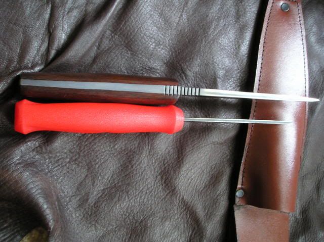

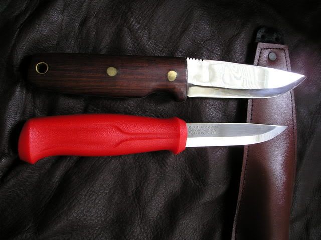

I recently got a new bushcraft blade which I was hoping to make my 'go-to' knife. Unfortunately, I just cannot get the thing sharp. It's a convex and probably the first one I've ever had. I've read a lot about sharpening this type of edge and have been working at using a mousepad with various grits of sandpaper on top. I started with 600, then worked down to 320 when that didn't work. Tonight, I finally tried 100 grit in an act of desperation. No luck! I just can't make this blade cut.
It's a pretty thick blade:
..but I don't feel like it's so thick that it wouldn't be able to sharpen up decently. (The blade for comparison is a Mora 510.)
I feel like I'm doing things as per various instructions as far as the stropping technique on the sandpaper and understand the principle well enough. I have no idea what the steel type of the blade is, which may be playing a factor.
Anyone have any tips of experiences trying to make a convex actually cut something?
I'm really learning to appreciate my Moras a lot more-a after all this. Those scandi blades will sharpen up in a jiffy.
Thanks for any thoughts or advice...
-Spooky

Part of your problem is that is a lousy blade grind. It is a very narrow saber grind which gives you a rather obtuse honing angle. You need to sharpen rather flat on that surface to get reasonable cutting performance. When you sharpen that close to the primary grind angle you have to remove a lot of material (a lot of work). I would use a belt sander and convert it to a flat scandinavian grind like the Mora (as a minimum). Actually I would lean on the belt sander and widen that bevel by at least an eigth of an inch.
Experiment with cutting some cardboard. No matter what edge you put on that thing it will really drag in the cut.
If you don't have the patience to do heavy rework on the blade, just sharpen it with a file. The rough edge finish that a file leaves is perfect for obtuse blades like this.

i notice that it looks like a scandi grind with the shoulders rounded a little bit.
it would probably work out okay, except that the steel looks to be about three times thicker than the mora, and therefore the edge will be very thick.
i would also suggest taking the shoulders of the grind back, either with power tools or alot of work on a stone or with rough grit sandpaper on a flat, hard surface (glass, 2x4 etc) that will improve your cutting ability and possibly help out with actual sharpness
