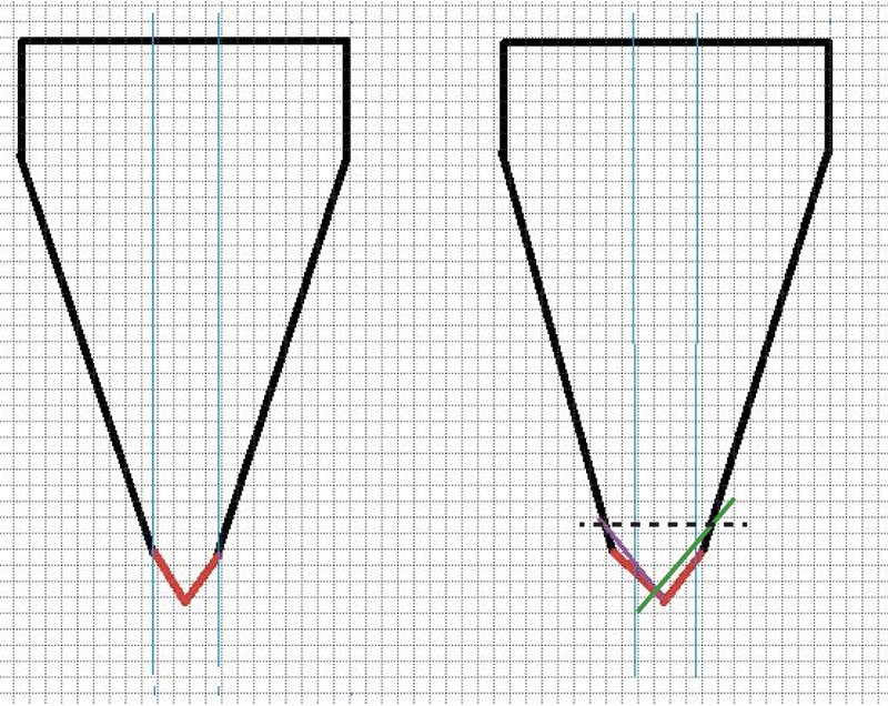

Hi all,
I’ve searched extensively as I’m sure this question must have come up before but I can’t find exactly what I’m looking for.
I’m sharpening a 110 PM2 for the first time on an edge pro apex (not my first time as I have some other PM2’s but this one has not been sharpened since new) and using a sharpie for checking the angles. I’m finding that on one side when all the sharpie is wiped off I turn it over and it only clears a tiny amount of sharpie near the edge.
I double checked the angles with a digital angle finder and I’m pretty sure that both sides the stone is hitting the edge at within 0.5 degrees of each other so pretty consistent at approx 16.5 degrees.
I have checked by eye and by loupe the primary bevels and centering of the edge and honestly cannot see anything that looks very different from one side to the other in terms of size of bevel. Centering if the edge in the blade stock I just cannot tell.
So the effect of sharpening very lightly with 1000 stone has been to produce a very keen edge which is a secondary bevel from one side and (an almost) primary bevel from the other.
My question is over the course of time which side should I be sharpening more to even whatever it is I can’t see out to make the edge more symmetrical?
I just can’t get my head around it because the two primary bevels look the same width to me and so I feel if I ground down the higher angle side (the one with most sharpie removed) I will end up with a very wide bevel on that side and it will look uneven. If I grind away on the other side that doesn’t feel right either because it’s already at a much shallower angle than the other side as denoted by most of the sharpie staying on. If there is a hard and fast tip for this situation please let me know!
Most likely the primary grinds are uneven.
You can choose make the edge bevels even looking by sharpen them at different angles or by grinding the narrower side more each time.
I grind the narrower side down to get even bevels over time.
This would make the edge off center, but you would not notice it.

Thank you very much for taking the time to sketch this I really appreciate it! So if I understand correctly the narrow side will be the one where I am wiping all the sharpie off at the moment (the bigger angle side - green in your diagram)? Is it possible that my edge is not centred from the factory as the bevels currently look similar? So then over grinding that narrow side would increase the bevel on the narrow side to be wider than the other side but push the edge into the centre? Or would you suggest grinding the other side (purple) instead, if indeed I had even bevels but off centre edge to begin with?
Sorry I’m writing this in a confusing way so would you agree with the following rules:
1) If factory bevels are uneven width / same angles but edge is centred to the blade stock then grind narrow green side - results in even bevels but off centre edge. Most material is removed from the shoulder where the primary bevel on the narrow side meets the rest of the blade stock.
2) If factory bevels are even width /uneven angles resulting in edge being off centre then grind purple side (the side where only a tiny bit of sharpie comes off near the edge) - will result in even bevel widths and edge will be centred BUT a lot of edge will have to be removed.
How can one even tell if the edge is centred to the blade stock? My bevels look more or less the same width but one side must have a much steeper angle than the other, so maybe number 2) above is more my case?
I think you are overthinking.
These are the two possibilities (the mix as the third), and I don't think you can distinguish them.
If you want to keep the factory edge bevels, you can use the different angles to sharpen it (16.5 on one side and a shallower angle on the other).
If you want to sharpen it at the same angle, just sharpen the side with the shallower angle more at each sharpening session.
Eventually, you will have somewhat even bevels at the same angle.
I would not try to make the bevels even immediately nor care about the centering of the edge.
Thanks, I think that’s clear to me now. So to sharpen both sides at same angle I sharpen the shallow angle side (the one where only the sharpie close to the edge is removed) a little more every time. In your diagrams above that is the left side of the second and third diagram. This will eventually even out the bevel angles regardless of the actual cause of the original imbalance. The actual edge may not be centred but it does not matter / is difficult to detect from a functional and aesthetic perspective. The bevels will be the same width however at the end of the process over a number of sharpenings.
Please shout if I have still not got it right lol!
Would you say my post above is factually correct now? Ie I sharpen the left side of your diagrams that apply to my case. The side with the sharpie only being taken off the edge side of the bevel rather than the whole bevel?
Yes.
If you are fine with the angle, you can just sharpen the shallower side (left in the diagram) away more than the other side each time.
That is what I do on my knives.
