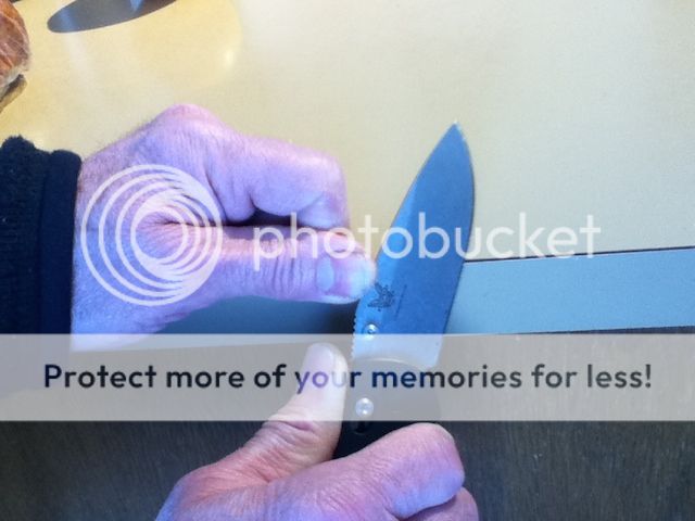

You can imagine but photo to follow. Using the King of this work so far Ritter Grip in M390. No mods I just use it, and use it and use it.
I either push with my thumb or pivot the the blade tip forward by swinging the handle back toward me; then advance both hands forward.

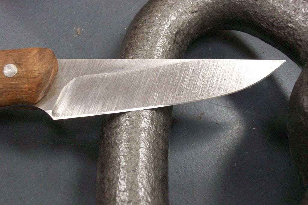

Included some pics - first one the edge off of wet/dry over Washboard, flat and clean. It is possible to reduce inherent rounding off of wet/dry to an imperceptible level if properly handled.
Next two are off of the diamonds, turned out great. As an added observation, the primary grinds on this are top notch in terms of geometry, and even though a testing blank, no warps or any other issues. Side to side uniformity mirror image.
